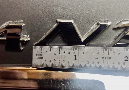

    13,276
    Re: 3d print lettering?
    (Upsidedown) Letter N on the right side of the machine
    3d print lettering?-img_20220305_085723761-jpg

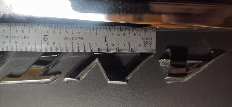

    13,313
    Used to run an industrial model shop (before 3D printing was invented).
    What we would have done is to make a rubbing of the existing letter. We’d use that as a pattern to trace onto a piece of plastic, cut it out as close as possible, and file the edges to the exact shape and draft.
    Alternatively you could scout around and learn what they used for a font. If you can get a vector profile of the letter, it’s easy to extrude it with draft into a 3D shape.
    ABS can be plated, but cost is probably prohibitive. You could try some Chrome paint. We would ordinarily paint over the whole ting so it would match.
    Attached Thumbnails Attached Thumbnails 3d print lettering?-067b0f85-34b4-4b65-9b20-0a8d44194e65
