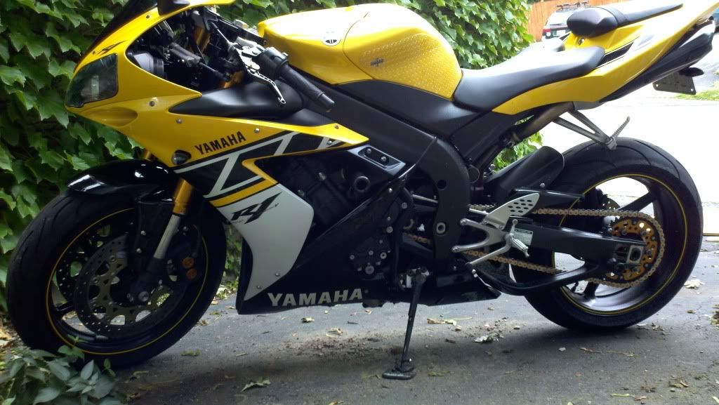

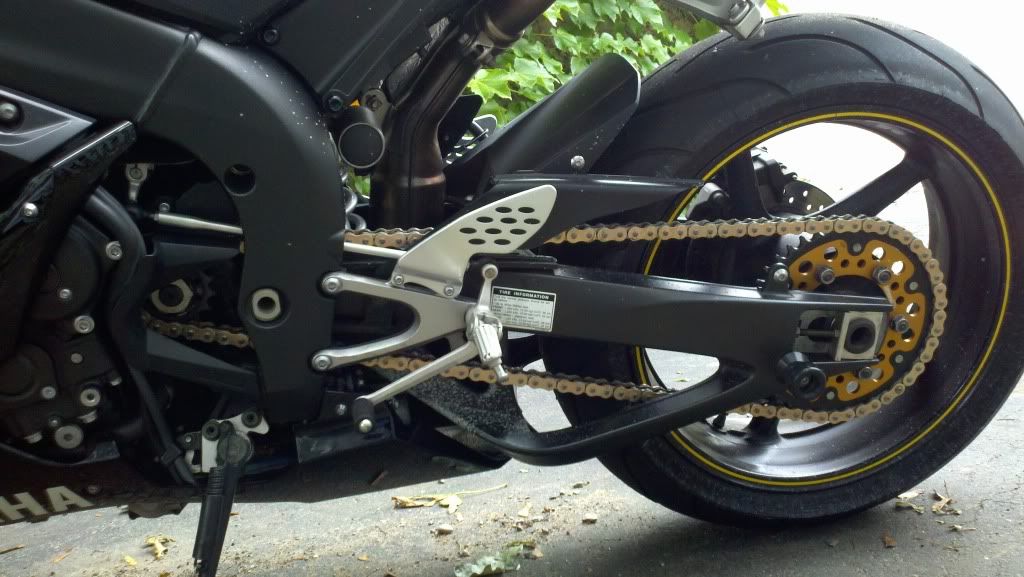

    Had a little free time this afternoon so i decided to go ahead and do my 520 conversion chain and sprockets.. went down 2 in the front and down 1 in the rear. Before anyone asks why I went with that combination, it provides the same gearing step as -1/+2 but it also extends the wheelbase by an inch or so due to the smaller sprockets. Makes the bike less wheelie prone with the steeper gearing. Although on my test ride it was pulling the wheel in 2nd and making it very light in third.. I'm sure if there was any less than 230lbs tucked over the tank it would have been crazy...

    That chain looks too tight.

    Nice bike. And as stated above, the chain is way tight. Let some length out of the adjusters.

    I'm no expert but the chain does have about an inch of free play.. the service manual says thats good. I know sometimes manuals suck so if it should be looser what should the play be?

    can someone tell me what the chain should have for slack? I'm just going by what the manual said. It does look like it's pulled tight in the pic but the play is there if you move it.

    It's a feel thing but from the photos if it was my bike I would loosen it until it just about hit the swingarm, on my 636 my chain does touch the swingarm. My old bike was a gsxr and the spec was .75-1.25 or something and that is way too tight.

    about an inch while youre sitting on it.
    if you have an inch now and it looks tight without you on it, imagine what it looks like with you on it.
    He'll have nice chain groves in his swingarm if he follows your advice
    1" - 1 1/2" is a good amount of slack, I'd lean more to 1 1/2".
    IMO if you have 1" of slack now being brand new, you'll end up with 1.5" shortly anyways. I'd run it as is if you're confindent you have 1" of slack.
    Not quite. I've run all my bikes, street and race, set up similar to how Greg described and haven't seen a swingarm become eaten by the chain yet.
    The chain tightens as the suspension compresses so what was previously barely contacing the swingarm without weight now has clearance with weight.
    Do a search on the R1-forum and get back to me on that It's the bottom swingarm brace that will get chewed. I even have a small contact point in mine and I was lucky if I had 1.5" of slack.
    Also the chain tension with weight or full compression varies with each model, so what may have worked on your bike, may not on his
