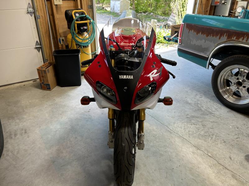

Beautiful work Mark
Your attention to detail
Stunning looking bike
:D

Beautiful work Mark
:D

OK, so looks like you'll need a new project by JUNE 4th...
Looks great out in the sun, appears the paint is in really good condition. :twothumb:
The bodywork that’s on it, appears to be new.. but was damaged in shipping. There’s not a single road chip in them, and no marks around the mounting tabs. The paint is perfect, there are are a few cracks in the fiberglass.
I have 3 fuel tanks now, two standard tanks, and one YEC tank. 2 in perfect/new condition, 1 has very minor use scratches.

Are those forks OEM? They look pimp as hell.
They are the OE forks, that have been modified. The stock R7 fork bottoms have been replaced with a radial mount brake caliper set up.

Yeah, it's those fork bottoms I noticed, performance internals in the forks too?
