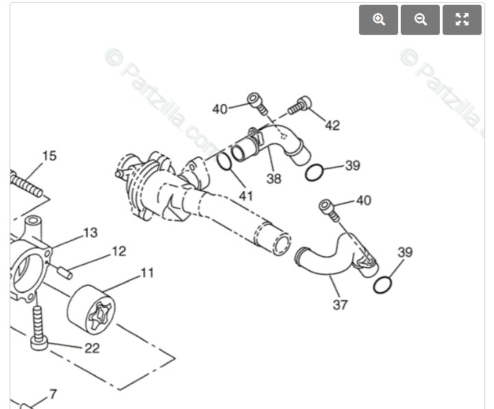

Quote:
Originally Posted by
R7
Radiator hose.
5FL-12482-00-00
For me, priority parts are the air box, coolant hose, and the TB gaskets.
The coolant hose is unique, it’s the metal type that bolts to the top of the head in 2 places.
My 2003 R1 coolant tubes look like this for the two that bolt into the valve cover. Oring slides onto the end. May be very similar or something you can modify. At least if the head interface worked, it would save a lot of work.
https://www.partzilla.com/catalog/ya...r1r/water-pump
Random website has pipe 2 for sale. other seems available
https://www.megazip.net/zapchasti-dl...00?shipper=usa
Attachment 59330
Attachment 59331
Re: Bad decisions were made today..
jimmycapp
I saw those on partzilla and thought about it, it could be a last resort option to try but I’m pretty sure the tube diameter is larger on the R1 part. I was hoping the older YZF 750 would have a similar set up, but it doesn’t
