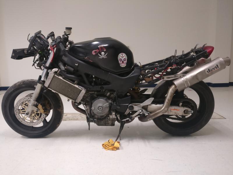

    Click here for video
    Cheap Honda Superhawk Build Video/Thread-img_20180412_161604-jpg
    It's the roughest motorcycle I have ever seen. Pretty much everything non-essential had been removed, plastics, fenders, turn signals, etc. Only stuff left was rear subframe, seat, wheels, tires, brakes, motor, chain, gauge cluster, rear brakelight (ziptied) and aftermarket LED lightbar. Brake lever was broken, clip-ons bent, dented tank, shifter was off the wrong bike and held together with zipties, clutch lever bent, seat ripped, in general super dirty, leaking fork seals, etc.

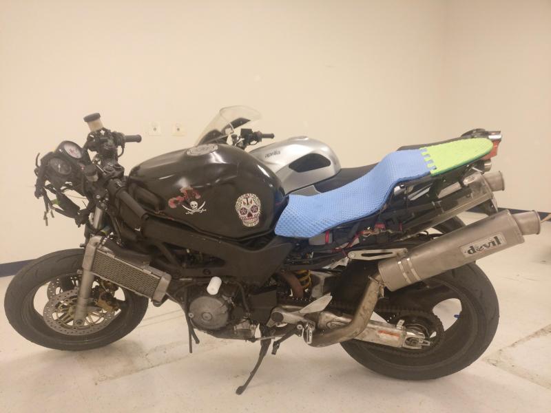

    Cheap Honda Superhawk Build Video/Thread-img_20190923_210206-jpg
    As it sits now, picked up gsxr1000 fairings from a friend for free.99, trimmed the insides a bit and they fit right up! Next up, a couple more fairing brackets to fab, patch the fairings, and then safety wire! Getting excited for round 7!
