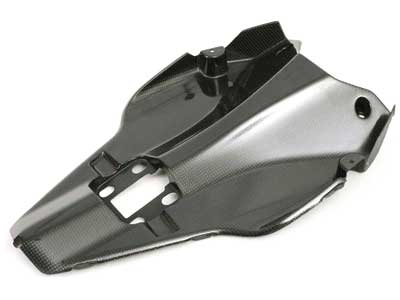

    Are you describing the 'undertail'? This piece already exists and I plan to leave it there. It is mounted between the exhaust pipes and the rear subframe / tail fairing.
    If I run no tail fairing, the undertail will prevent spray from the rear wheel, but TC sensor will still be exposed to rain water from above. For reference, this is how the stock tail fairing is made, notice the cubby? that's where the TC gyro is mounted from factory. And that is the piece I'd like to not run.

    Gotcha. Is there room for the module between the under tail and seat?
    Other problem you may encounter here is how the module is mounted. If the gyro is oriented in a specific way in the location in your tail section, you may encounter problems with the system if its static position isn't exactly the same as where its supposed to live. I don't know enough about the module to say whether it adjusts to a different orientation or not. For example, if the new position of the box is mounted with the front higher than its original, it could think the bike is perpetually in a wheelie . No seriously.
