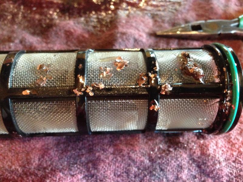

    So I smoked the rod bearing in my 2011 848 race bike at the last race. Trying to decide what to do with it. I had planed on selling it at the end of the season to fund a new build for next year, but now I'm not sure what to do.
    1. Rebuild the engine over the winter, run it again next year
    2. Buy a used stock engine and finish the year in it
    3. Part it out to get back what I can. This thing has every trick part on it.
    Opinions?

    I going in with the assumption that the crank, piston, and head in the front cylinder are damaged based on the noise I heard and amount of copper I pulled out of the lower end. I have not pulled the head off yet to see though.

    Wow! That's a lot of material. I would buy a new motor. A quick search found two under 1,700

    Eeck looks like one of my Buell engines that went bad...
