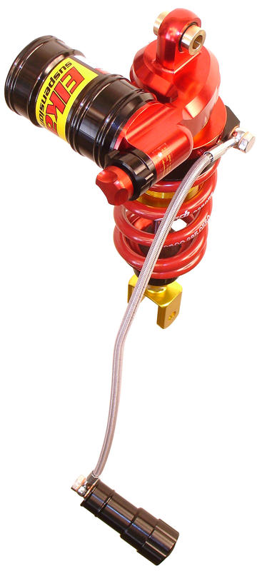

    After riding ~1k in four days this past weekend through MA, VT, NH and upstate NY I have quickly realized the rear shock on my 2009 Yamaha Fz1 is very inadequate, especially riding 2up and with loaded Givi E55 topcase. It was bad enough on Sunday when the temps started increasing that we pulled over to make sure it had not dump it's oil.......
    So I started looking for shocks that the spring preload is hydraulically adjustable, to make adjustments easier for traveling 2up with luggage. I found the Elka Stage 4+HYD, hydraulic spring pre load adj, low/high speed compression damping and rebound damping for $995. Anyone have experience with Elka products?
    Also anyone have experience with Nitron or Hagon rear shocks? I looked @ Ohlins, but the shock lists for just under $2k, on the Penske site I did not see a hydraulically adj spring preload option?
    Elka shocks, good or bad?....-moto-46-stage4-hyd_downwards2-jpg

    Elkas have a good rep and a larger diameter shaft than some other shocks
    another option for a hydraulic preload is WP, but pricey, I paid nearly $1300

    I put an Elka on my track bike (02 ZX6R) a couple years ago and like it, I'd buy another one if I had to. Made a HUGE difference over the stock shock. When they shipped it they sent me all kinds of paper work for a dirt bike shock, I wasn't happy so I contacted them and told them to send me the street bike shock manual. Next week I got the manual I wanted, stickers, and hat. It was a nice customer service touch!

    I put one on my DL650 V-Strom. These shocks are the forum darlings, likely partly because Blair from SVRacingparts.com does a really good job marketing them there.
    The more I ride it, the more I like it. At first I wasn't sure I could tell the difference. Which sucked considering how much it cost. But I think I have my bike pretty close to dialed in for my riding. Now when I ride something else and come back to my trusty V-Strom I fall in love with that fugly ass motorcycle again.
    Personally, I found doing proper sized springs and emulators the biggest night and day difference for this bike. But it was woefully under-sprung for me. I dropped new springs, oil, and race-tech emulators in my damper rod forks all at once. That was a real night and day difference. I did the rear a year later and it wasn't as huge of an impact. Although I do think it helped ride significantly.
    The only hiccup was the line to the remote pre-load adjustment was installed pointing the wrong way.
    must be a V-strom thing, same hiccup with my WP on my Vee, but excellent service from FactoryConnection, they made a house call and flipped it around

    I got my Elka through John; he's awesome to deal with, and stands behind his work & products 100%. Mine is not hydraulically adjustable for preload, which would be a nice feature to have. The preload collar is opposite of stock, and requires the gas tank to be moved for access. Other than that, the shock is well-built, and performs on a level far exceeding my abilities.
