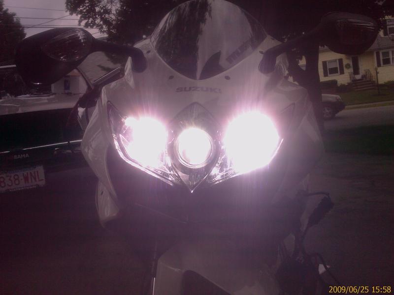

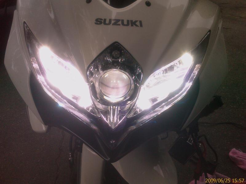

    Headlight incandescent bulb, HID or Halogen bulb-imag0269-jpgHeadlight incandescent bulb, HID or Halogen bulb-imag0270-jpg
    Pat. The center is a proper hid retrofit.
    If you put Hid's in a reflector housing, like the 2 on the outsides, you light up trees, piss people in front of you off.
    I used them for flashers, passing, and daytime "hey dont run me over" traffic riding.
    These were 8000k I believe.

    Yeah Chris, but what about your two outside lights? What did you have for bulbs in Thoes?
    Jan 2009
    Waltham
    2,376
    Re: Headlight incandescent bulb, HID or Halogen bulb
    Quote Originally Posted by zzrrider View Post
    They were all the same bulbs... Just different housings. The middle was a projector and the outsides were reflectors.
