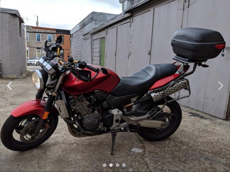

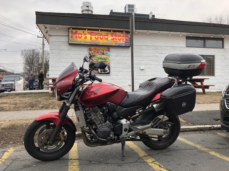

    I picked up a Hornet last summer.
    Backstory: I had a Yamaha FZ6 that was my street bike for practically forever. About 2 years ago, I made the mistake of test riding a very well equipped Tiger1050, fell in love, and sold the FZ6. After a few months, the height and heft of the Tiger started getting old. Sold the Tiger to a friend and found a nice DR65o and was enjoying the lighter weight bike for my backroads commute. A couple months later, I stumbled across an ad for a very low priced 919, thought "hmm, this is better for occasional highway or 2up than my DR..." Made the guy an even lower offer, he said "sure", drove down to Baltimore and grabbed it.
    It's a 2007, had 33k miles on it. It's not perfect condition but certainly not a beater. Had a solo Corbin seat, renthal handlebar, pelican cases on Givi racks, and a Givi front fairing that wasn't installed. A folder with paperwork showed the original owner purchased it in San Diego. The kid I bought it from had it for 2 years and put ~300 miles on it.
    I swapped the handlebar for a taller one from a quad that I used on my FZ6, purchased longer SS brake lines to use this. Replaced the bar-end mirrors with some cheap standard mount ones from amazon that are surprisingly good. I traded the solo Corbin for a dual Corbin which I found more comfortable. Adapted the racks back to use the Givi cases I already had. Installed the Givi fairing, I like the looks better without it, but it does make a noticeable difference. The suspension isn't great, but for my purposes I don't really care. I do have some 1.0 springs from my old F4 track bike kicking around that I might drop in.
    It basically feels about the size of my FZ6 with a motor a lot more similar to the Tiger. Seat height is low enough that I can back it down my steep driveway between the cars with no issues. Accidentally wheelied it whacking the throttle 2-up. It's probably a "boring" bike by most standards, doesn't particularly do anything well, but it seems to be a pretty good general street bike.
    Before and after pics
