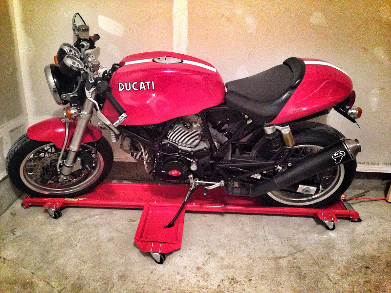

    Watched my buddy move bikes around with one of these the other day, worked a lot better than I expected. Does that work?
    Attachment 45880
    Not really, its 1/4 mile to the first pond, 1/2 mile to the second pond...all trail. Unfortunately I think the second pond will make a better ice track.
    downhill all the way ? you could ice up a trail that would double as a bobsled run
    Both up and down, but as mentioned above, its a bit far
