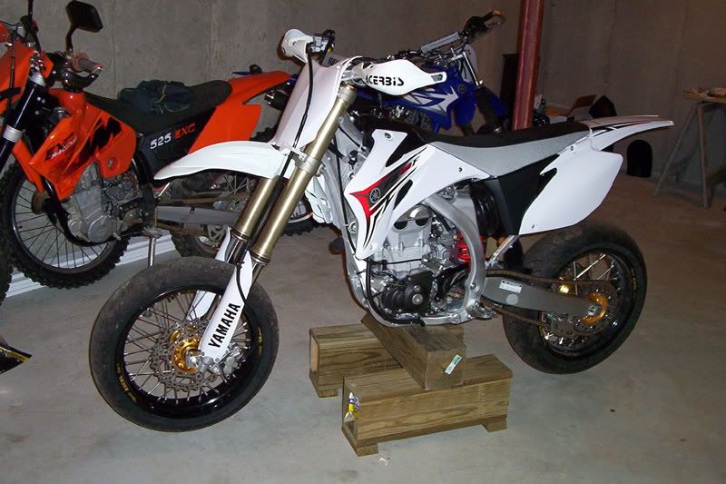

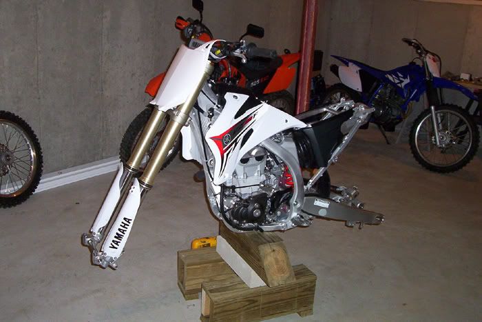

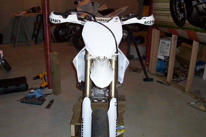

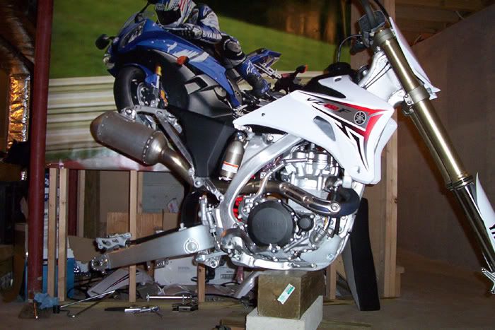

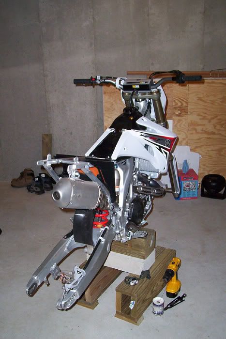

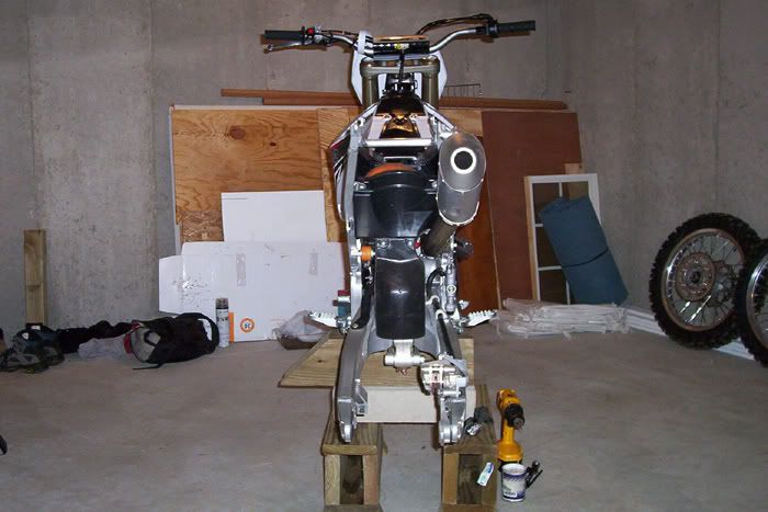

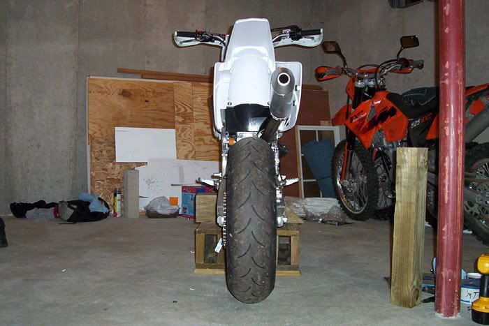

    Anyway, I figured I'd take a couple pictures of the bike as it sits in my basement. I haven't had time to set up a workshop down there yet so don't give me any shit about the mess
    I'm praying that tomorrow night I can update these pictures

    That bike is hot, Mark!
    And you have the same R6 banner of Jason DiSalvo that I have in my garage.
    Looks like your basement needs the 'garage guy' treatment

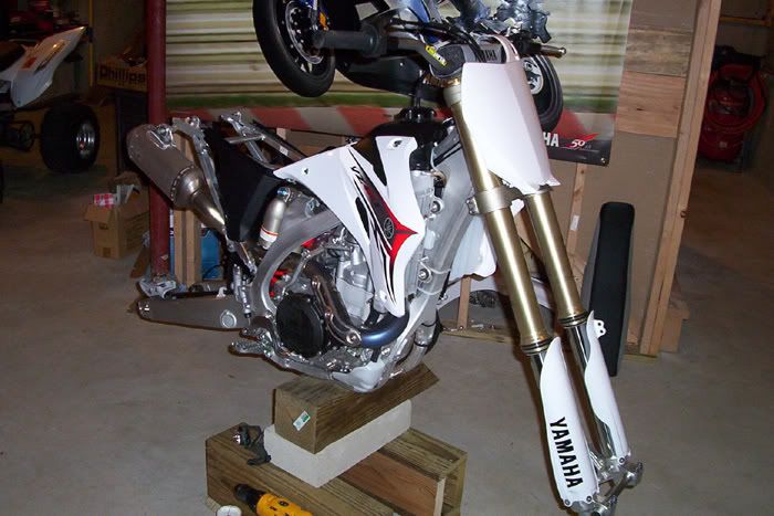

    Looks kinda cheezy without the big brake but you get the idea
