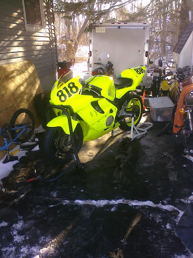

    I want to mount LEDs in the ram air vents on my F4I, then re-route the ram air. It has race bodywork and i want to keep it looking race but put it on the street. Any one know of a small/bright enough LEDs for that?
