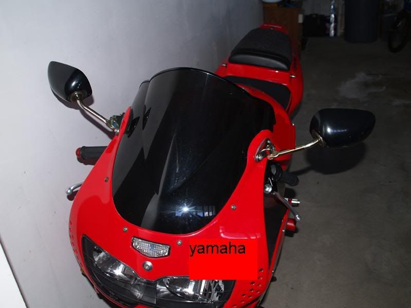

    I really hated the look of the stock mirrors on my CBR. Those rubber boots over the stalk were hideous. I purchased a set of Targa Formula 1 Mirrors, but they ended up having really short stalks and all I could see is elbow. They also have less adjustability than the stock mirrors.
    So, I put the stock mirrors back on and cut the boots off. Now it looks ok, but I would prefer the metal on the stalks be black and not the gold color. I wrote to Greg about powdercoating, but since the mirror section can't be separated from the stalk without damaging the actual mirror, they can't be powdercoated, due to the plastic being melted when they're baked.
    So, does anyone have any other suggestions? (besides rattle canning the things) Here are some pics of how they look in the gold:

    how bout gun blueing

    OK, I'm ignorant. What's gun bluing?

    This isn't solving my issue though. I like the mirrors, but don't like that the stalks are gold.

    how about getting the metal annodized

    I wouldn't count out the rattle can option. If you sand the stalks down, clean it with a good prep alky, prime, then do a few coats it will look great and last. Proper prepping goes a long way, as does taking plenty of time to mask everything off nicely.

    Painting is definitely not my forte. How many coats did you put on your headlight? Is it going to stand up to the abuse of the elements that wioll pound on it? I'd just hate for the paint to flake off.
    In other words, I'd rather pay someone to do it right.

    I scuffed the metal up with some mildly abrasive sandpaper, then cleaned all the sanding dust/crap off with paint prep alcohol. Two coats of black metal primer, then three coats of Krylon top coat.
    So far it's held up fine, but I'm sure if a big enough stone hits it that it will chip a little. The only thing that is going to really take the paint off are rocks or actually scratching it with something sharp; basically the same as the rest of the paint on your bike. Since powdercoating is basically out the question, I'd say it's your next best (and cheapest) action.
