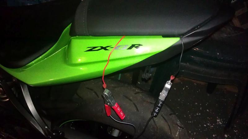

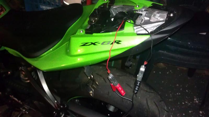

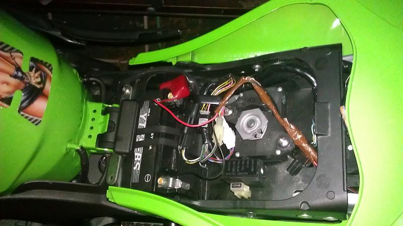

    Silly mod but I won't need to remove the front seat to charge my battery anymore. I ran some wires from the battery to the rear seat which can be pop open with a key but not the front, required unscrewing 2 bolts, to much work. Wired are tuck away clean after the pictures were taken. What do you think?

    Good job bud, but they make wires for that you know......really cheap and less work. Did you use electrical tape?

    nice mod, what're you covering the exposed wires with after you're done with it?

    Oh I had no idea they sell wires for that. I just had some wires sitting around from an old HID kit from my car. So I used them.

    That's actually can be considered. But right now this works fine. After done charging, I just roll the wires and put them under the rear seat.

    much better way to go. if you don't cover the end of those wires you risk the positive wire bouncing around and touching the frame or the negative wire and shorting shit out. This wire you just put the cover on the end when not in use. and of course most chargers have that connection already so its easy to hook up.

    I cut/ spliced an end connection from NAPA that perfectly fit the Battery Tender one. So therefore my NAPA battery tender has the end of the Battery Tender brand. Also I bought one of the battery tender "female" pieces so I can plug in a phone charger or GPS. Works wonders.

    Good stuff....but like those above said make sure there are no exposed wires. Nice bike by the way!

    Maybe its just the pictures, but those wires look pretty dinky to be charging the battery.
