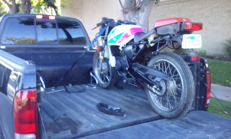

    Stupid google plus won't give me links in the app when mobile
    Attached Thumbnails Attached Thumbnails ns50-20150303_074435-jpg

    yup...rear left tail fairing is in the truck...bike is otherwise complete with only 472 miles

    Re: ns50
    time to get this thing going...
    history:
    -bike owned by PO's father - passed away - been sitting "registration paid" - not true. Bike is out of the system - need to have the VIN CHP inspected and apply for new plates
    -looks all original minus painted rear seat cowl and aftermarket rear turn signals
    -front turn signals stalks snapped off, but still wired - may be able to re-attach those stalks and run the oem signals
    -bike only started when seller sprayed starter fluid into carb and kickstarted - but it ran
    -bike is oil injected - need to clean out all the old oil that's been sitting in the injection system
    -LOW mileage - 480!!
    my guess (like the last 3 bikes I've gotten started) is that gas isn't coming out of the gas tank - tons of rust in the tank and the petcock. That's why it started w' starter fluid - it used that + oil from oil injection to start
    I'll start by cleaning the carb, gas tank, likely a new fuel petcock, re-attach the front signals, tranny oil change, oil injection system oil change, get some fresh tires (these are 25 year old NOS ) and run it at a day when nobody's at a kart track...then once it's mechanically sound, get the street registration, ride it a few months, do some canyon carving, $38 track days, then sell it.
