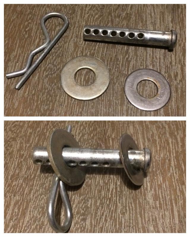

    I also have the HF chocks. Instead of bolting them to the trailer deck, use clevis pins, some jumbo washers, and R-clip cotter pins. Takes maybe 45 seconds to install/remove the chock.

    Do you have a picture or seven of how you have yours attached?

    From top down:
    3/8" diameter clevis pin, 3/8" ID washer, (chock, trailer deck), 3/8" or 1/2" ID jumbo washer, R-clip.
    Set the chock over the holes in the trailer, drop the pins with the top washers through. Crawl underneath and put on the bottom washers and insert the R-clips. Use the clevis pin hole that's closest to the deck, don't worry if he chock isn't snugged down tight like as if you were bolting it, the weight of the bike strapped down will prevent it from moving. Just use some pretty heavy duty R-clips, because when you're pulling the bike out of the chock, the clips and bottom washer will be holding the chock against the bottom of the deck.
