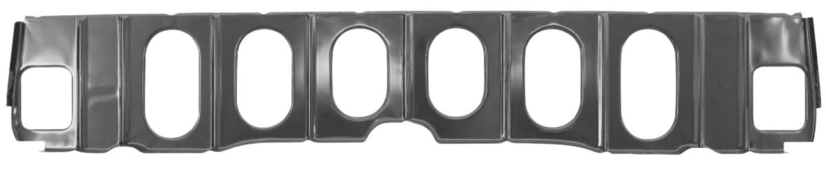

    It's for my '69 El Camino. It needs new floor pans (which I can buy) but it also needs some random support pieces (which I can't). I'm talking a welding course now so I'll start with the basics, but I might need some sheetmvetal tools that they don't have at the Artisan's Asylum.
    Quote Originally Posted by rg500 View Post
    I have both although I lent my brake to a family member. The bead roller is in my shop in Pawtucket, ri. What are you looking to do?
    Here is a support panel for a '67 El Camino:
    Unfortunately they don't make them for 68-72s, which means I'd have to fabricate something that achieves the same outcome. In this case, it's part of the structure that holds the truck bed to the frame. Mine is really rusty and probably too far gone to save. I'd get a photo if the car wasn't buried under 6' of snow...

    I could help you, but that is a complicated enough piece I would have to charge you. For about the same amount you could buy a bead roller. I seem to recall the harbor freight one is cheap, and only needs some relatively simple reinforcement to work well. There are some other choices available for a little more.
    For one, I wouldn't bother cutting and fluting (term?) all the holes. I would just do it with a simple piece of sheet metal and think it might need a bead to stiffen it up.
    I can't find a bead roller on HF's site..?
