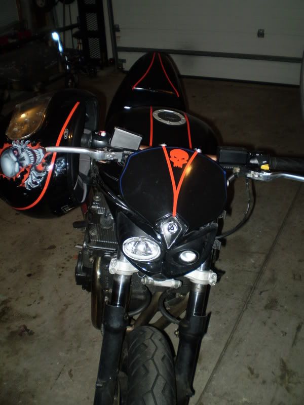

    New update!!! Had the whole thing finished... and was loading it on my truck... solo... bad idea
    pushin it up the ramp cuz the battery was dead... 2nd bad idea
    strike three... i can't push it all the way up myself cuz i only have one ramp... but i'm late for class and have to drive from RI to NH... So i give it one last HEAVE... and guess what... i pushed just enough to push it past the point of no return with me on one side of the ramp, and the majority of the 480lbs bike going the other way... It crashed off the ramp... 3 foot drop onto the handlebars, and dented the tank...
    sO.. another week of bondo and paint went by... i made my own straight bars for it, and presto... brand new again!
    Still need to paint the chain guard, rear rim, front fender, and swingarm.
    Heres a few pictures: 2004 suzuki bandit gsf 1200 s

    Holy shit.... that's fuckin' badass. I like it!
    Leave the front fender off, looks better without.
    Oh yeah, and get two 2x8's or 2x10's, along with those ramp-end kits you can buy from home depot (they hook onto the edge of the bed). One for you, one for the bike. Do it with the bike running, walk up one, clutch it up the other. No more crashie-crash.

    If you haven't made a seat cushion yet then get memory foam from an aircraft supply place. I put memory foam on my bike last winter and it was a huge improvement from stock.
