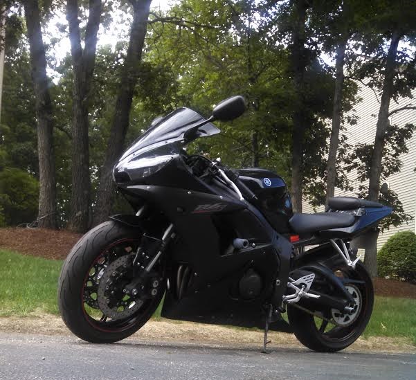

    I've been looking around for a track bike as an upgrade from my 09' FZ6R. I've been doing well with it in red group at tonys track days but it's weight and rider position really hasn't been what i've wanted. I looked around for an R6 and found an 05' that had gone down at a local dealer here in Nashua, NH.
    New track bike! 05' R6 - Need some help/guidance on what to do about the front end.-05-r6_6-13-15-copy
    I noticed it had been dropped when I bought it, and found out it was a clean title. So I bought it!
    I didn't quite notice how off the handlebars were until I started riding it though, it drives straight, but it leans to the right on the highway and it certainly turns easier going right than it does left. Sure enough when i looked at it, the wheel and the triple tree assembly arent straight. A friend of mine pointed me to this Dave Moss video https://www.youtube.com/watch?v=fbmF26_xPi8 and I gave it a shot. Loosening the lower triple tree didn't seem to do the trick.
    The next thing I am going to try is getting it on a front stand and loosen all the triple tree clamps and try to straighten it then. Looking to see if anyone has any experience in doing this and can offer me some insight on what I should do. Obviously take it to a suspension shop is my last ditch effort, but i'd rather have the knowledge to do this myself.

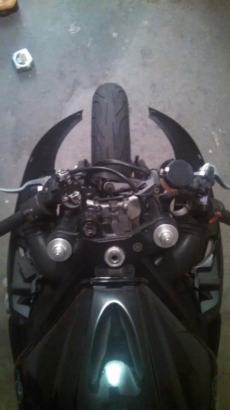

    Here's a pic with the front end removed that really shows how off it is.

    Honestly you can get it close by what you are doing but.... there may be more going on. I would if you are planning on doing some track days ECT. Have Peter K. put it on the rack and Zero it out and make it strainght and True. It’s worth all the money and won't turn on its own LOLOLOLOL.
    Geometry on a bike is key.....
    Computrack Boston Motorcycle Suspension Specailists
    Bike propb had a slight meeting with a car or the ground... I am sure of it

    Computrack for sure. Gotta start with a straight bike before you do anything else. I hope you got a good deal on the bike. Your looking at about a grand to make it straight.

    A good deal for that bike not bent would be about 3000 imho. If it hasn't been too long I would be back to the dealer. Get them to straighten that shit out. You didn't sign up for a bike that turns on its own.

    Hi Nick, i can check and repair that for you. If it's just the clamps that are bent plan on $275 for a measurement and front end alignment. If there is more damage than that, like the frame or bent fork tubes I'll get you an estimate after the measurement.

    and there you have it.......and for a fair price with out damge they are getting 3-4500 and a 07 R6 non S is from 4500-6500 from what I have seen on the CRAIGS
