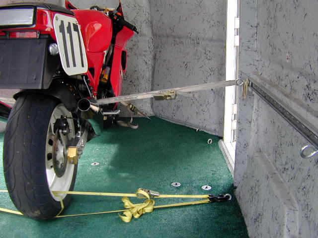

    I've always seemed to have a struggle with this (except when I had a kendon)
    Not looking to buy aything new like that. Trying to update my do it all5 x 8 landscape trailer on a budget
    Have a trip to PA and bringing 2 dirtbikes
    My front always seems to slide a bit so I'm thinking this, cheap removeable but I cant find anything other than this online.
    http://https://www.speedaddicts.com/...BoCCDYQAvD_BwE
    As for the rears I've always done the ratchet strap
    like the first pic flat perpendicular to the rear wheel but also get a some wandering of the rear tire and i adjust but cant seem to get it tight enough
    i'm trying this https://www.amazon.com/MOTO4U-Univer...s%2C110&sr=8-1 but with 2 bike, a d ring in the middle.
    any suggestions appreciated... have straps more towards the rear vs perpendiculat etc..
    Id like to get some more fancy options like this.https://www.amazon.com/Risk-Racing-0...7-857e17e03685
    but not in the cards right now.
    Also cant do the bike on the hitch.. Tried it...... almost busted my rear window out taking it off, not worth the riskhow do you trailer you Dirtbike/ bike-dscn1038s-jpg
