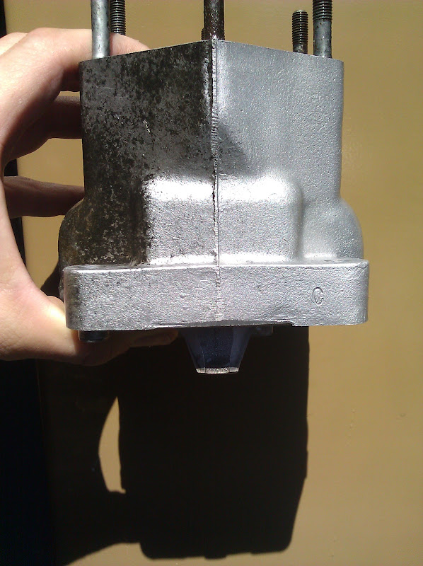

    more pics of some NSR parts
    cylinder half blasted
    Note the shadow straight down, no trick lighting
