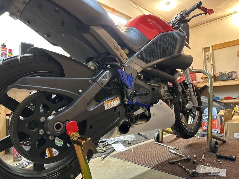

    Woot! Brakes are Go! Er, Stop! No judder, no pulsing, only vibration in the lever is Buell Charm(TM) from the motor. I haven't done a HARD stop yet, but at no point did the original rotor feel anywhere near this good so I think I've got that sorted. The new ergos have shifted the bike from feeling like a heavy, wide, no ground clearance version of my KTM 500 to a heavy, wide, all the ground clearance CRF70, it's compact now. Having the pegs slightly back might be nice, I've got the OEM drop pegs I could swap in but I'm afraid I'll need the ground clearance so I'll stick with this. Only concern noted on the test ride, I need to put some slack in the clutch cable as the new routing has it tightened up, easy fix. Will get that sorted and decide if I'm going to put a few more miles on today while it's still street legal, or go straight to stripping it down.
    while these motors do has vibe, if you notice this increasing over time, keep an eye on the front isolator (motor mount). the rubber can fatigue with heat and time which causes a bit of droop essentially hanging the motor on the main frame bolt that goes through the isolator. doesn't cause any serious issue but can be annoying.
