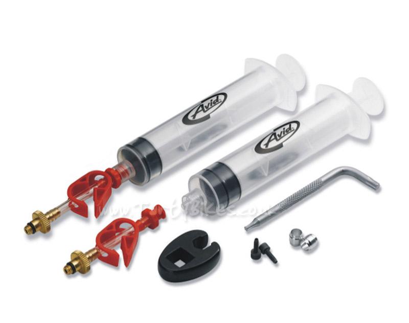

    My one piece of advice is to get a hose clamp that will hold the hose on the bleeder valve. Otherwise, you just pull air in from around the sides of the valve.
    This is why I asked if they had threaded bleeder valves. The bicycle syringes actually thread onto the bleeder to guarantee a good seal.

    I haven't seen threaded valves on a motorcycle.
    Do you know who makes them for bicycles?
    I tried googling it, but couldn't find any. The bicycle ones might be smaller but it would be worth checking out.

    Avid is the brand (as pictured), owned by SRAM and for use on SRAM hydraulic systems. Shimano also has hydraulic brakes but I don't think they use the threaded design.

    Threaded bleeder valves would be awesome.
    I've tried a mitivac. Never had any luck with it. I can never get it to get a good enough seal on the bleeder to not draw air.
