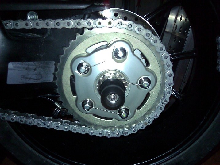

    Hi Guys,
    Would anyone mind looking at this photo and telling me if I've wired this correctly?
    Thanks so much for your time and stuff.

    Looks ok to me

    Looks OK to me too...

    most single sided swingarm bikes i've seen at the track usually just wire the nuts to each other, but yours looks ok.

    I've never wired those. Looks good though.
    I can't tell from the picture but make sure you wire the clips for the axle nuts to themselves to keep them from spreading and possibly falling off.

    Great Job Diz. Looks good to me

    I just checked out your page. It looks like your front left caliper bolts may not be wired quit right. You want the wire to go through top bolt at about 3o'clock your bottom should be about 9o'clock(which yours is).

    FYI, I tend to fold the extra wire in half & out of the way. your way works, but still exposes a sharp point to a hand.
    The better way is to twist the extra wire until it breaks. That way there is no sharp ends anywhere and bending it can kind of be a pita.

    Thanks Tim, you're spot on; it's just not quite right. I did the calipers early in learning to do this and I think my skills improved as I've worked my way through. Gives me an excuse to clean it up a bit.
