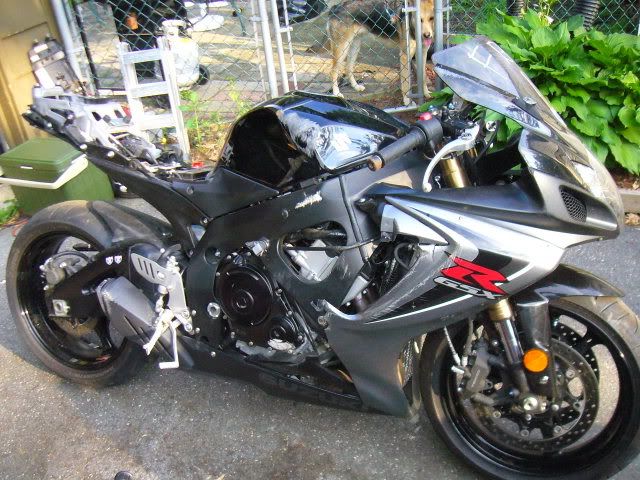

    I got a good offer on my clean title 2003 GSXR 600, and I'm taking a break from the street for a few months, so I figured I should get a platform that would have some extra goodies, and be a solid race bike for a few years.
    I picked up a salvaged title 2006 GSXR 600 this weekend. She is going to be a beauty. Some pics below, as well as a progress thread.

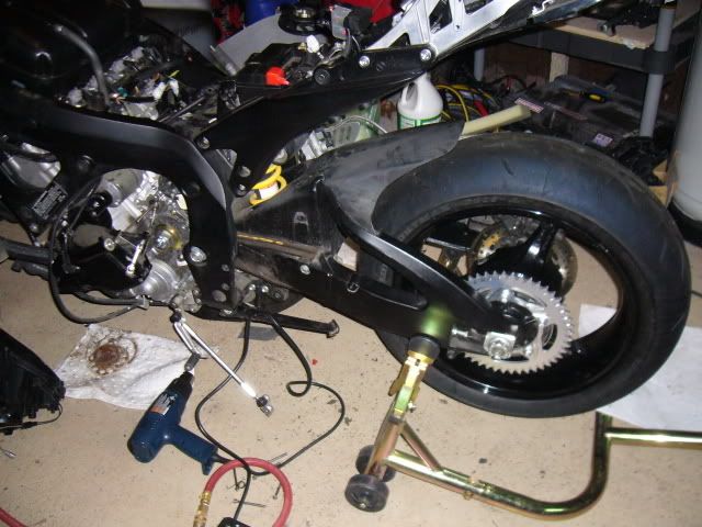

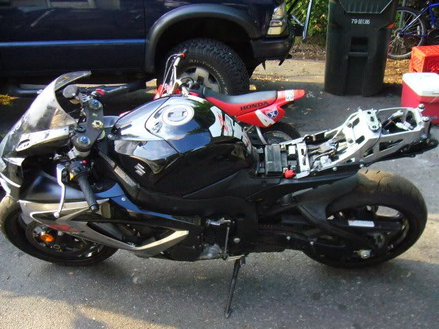

    Day 0 - 6/3/07

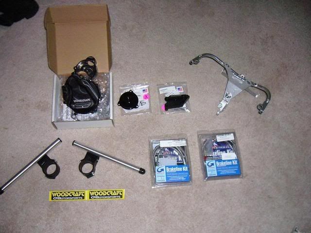

    Picked the bike up, as well as some goodies.
    Day 1 - 6/4/07
    No Progress, Rained and garage was too crowded to wrench. Charged battery. Learned that the battery had gone dead by being parked on a cement floor all winter, and the current actually being drawn out through the kickstand.
    Day 2 - 6/5/07
    Made Jumper wire to jump couple harness wires to put the bike in "dealer mode" and got 2 trouble codes.
    C23 - Tip Over Sensor
    C46 - Exhaust Control Valve actuator
    C46 does not effect the bike, since the full exhaust is being removed howeer C23 prevents the bike from starting. I borrowed a TOS and started the bike o make sure we'd be good when it all comes together for next week's races.
    I am researching voltages the computer is looking for in each of these inputs so I can install resistors and erase the codes permanently. I also plan to make a hard-wired switch that will be mounted somewhere accessible for easy "dealer mode" control.

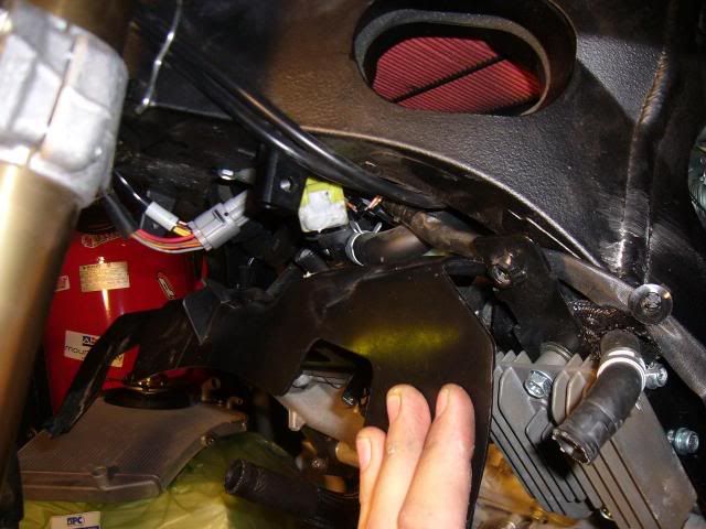

    Stripped several unnecessary street parts from the bike.

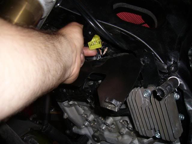

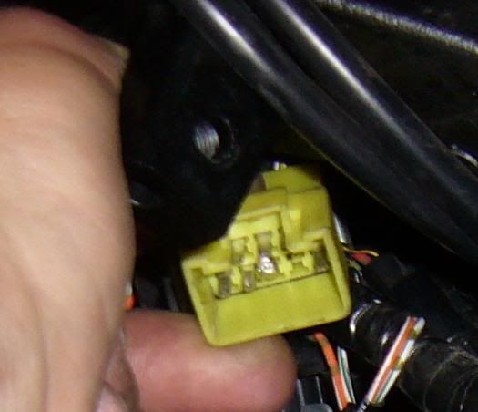

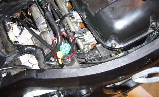

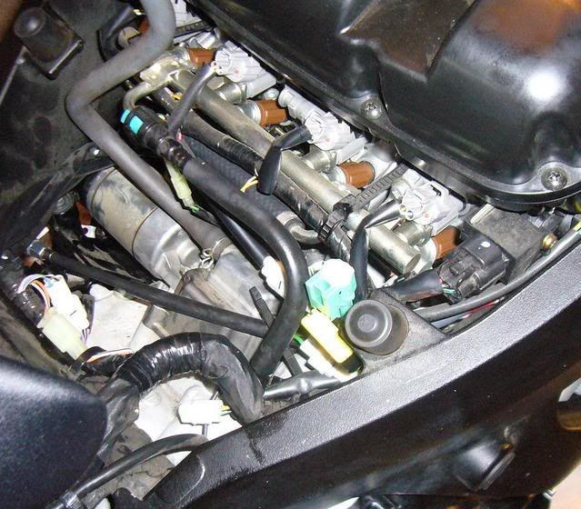

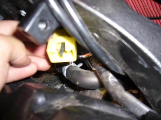

    Day 3 - 6/6/07
    Made Bypass for TOS, bike will now start. $47 part is unecessary and not ordered!
    C23 - Tip Over Sensor Cleared.
    This was done using a pair of 150 Ohm resistors as shown below, then the plug was packed with silicon. Waterproof bypass.

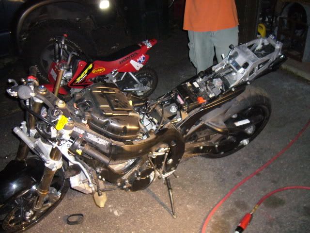

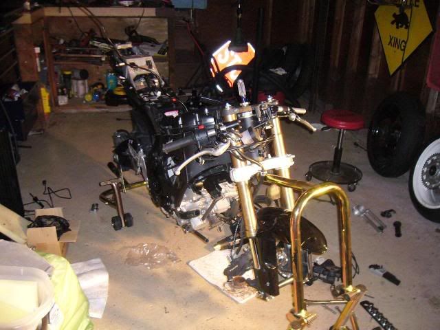

    Exhaust, Radiator, Left Handle Bar controls, steering damper, horn, exhaust valve actuator removed... Will most likely need to create a jumper to replace the clutch engagement switch (that requires clutch to be in to start) since the switch has been removed.
    Woodcraft clip-ons installed

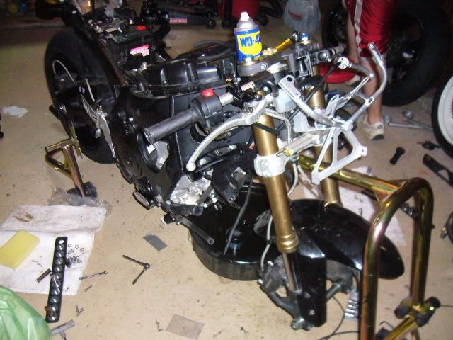

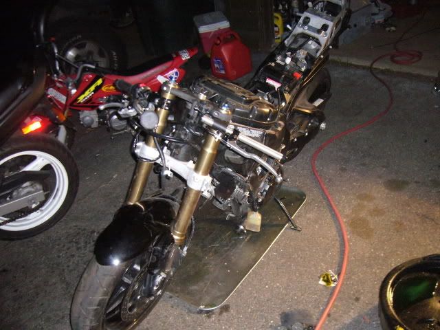

    Day 4 - 6/7/07
    Made Bypass for clutch switch assembly, with left controls removed.
    This was done by soldering the 2 middle pins on the 10-pin plug together.
    I then put heat shrink over the center 2 pins to ensure no arcing to another pin. Lastly, filled the harness with silicon to make waterproof.
    front sprocket, wheels, chain removed... Thursday night, time to drink!

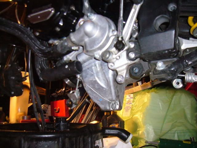

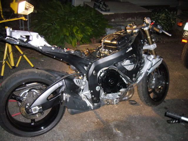

    Day 5 - 6/8/07
    -Fresh oil change
    -Vortex F&R 520 Sprockets installed (15/47)

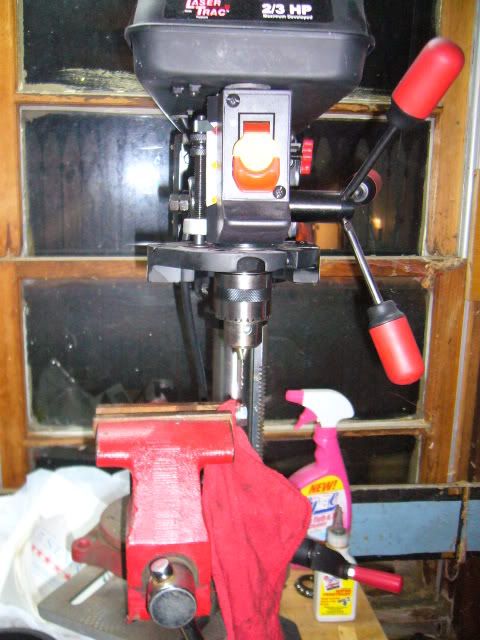

    Oil plug, filter, caliper bolts, pinch bolts - drilled for safety wire (more to come).
    example:

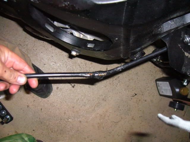

    Repaired chafed clutch cable, re-routed inside the frame (see right engine cover pic).

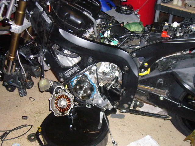

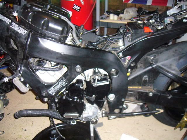

    Installed Engine covers (left and right).
    Installed SS Brakelines, front and rear... Ohlins steering damper, Graves racing stay.
    Made Bypass for kickstand switch.
    This was done by soldering the 2 pins together in the switch's harness... filled the harness with silicon to make waterproof.
    4AM, birds chirping, time to sleep!
