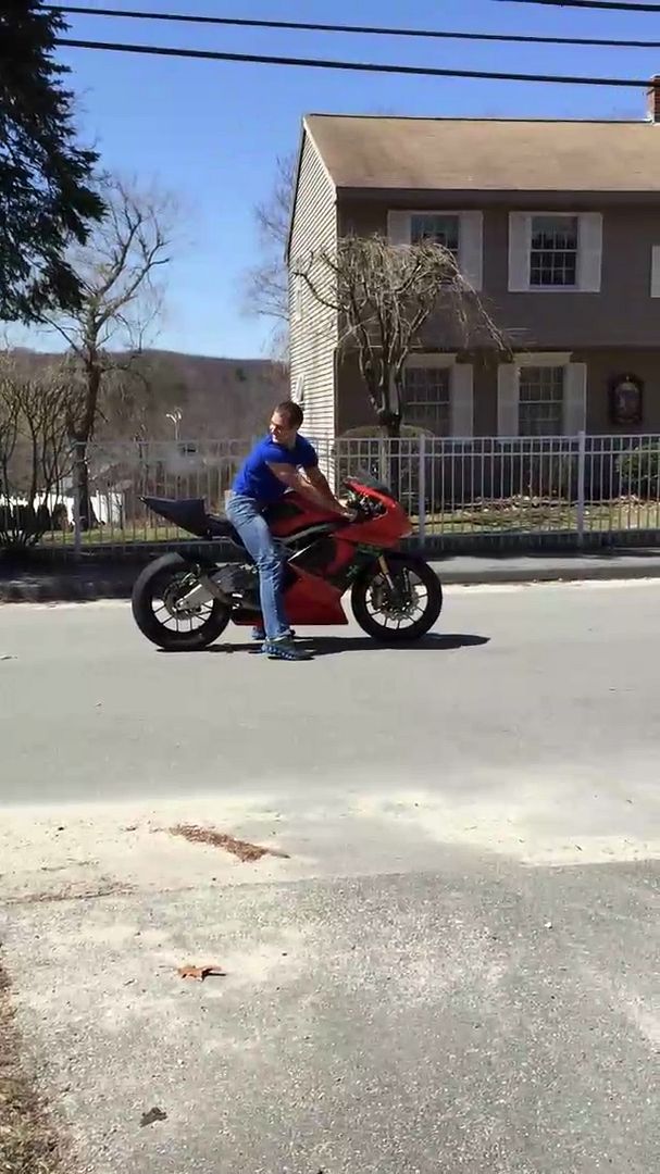

  24. #149
    Re: How can you race TT Isle of Mann?
    First time ever on a Kawasaki EX650, not just launching it, first time ever riding one:
  25. #150
