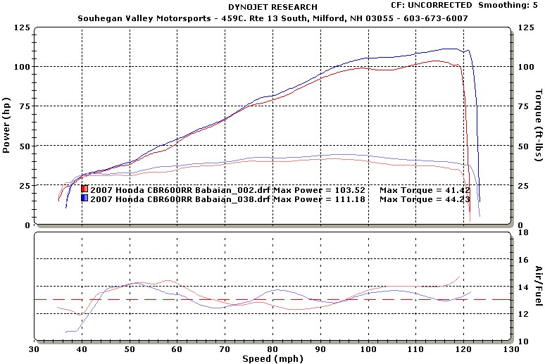

    got the dyno sheet last night, midrange looks good still. I was worried I'd have a dip there and would have to start shifting all over the place like you R6 guys
    Attached Thumbnails Attached Thumbnails Are velocity stacks SS legal?-babaiancbr-jpg
    11,981
    Re: Are velocity stacks SS legal?
    yup. and its the R1 that has variable height stacks, I don't think the R6 does.
    08 and up R6 has variable stacks.
    The gain is from stacks alone??

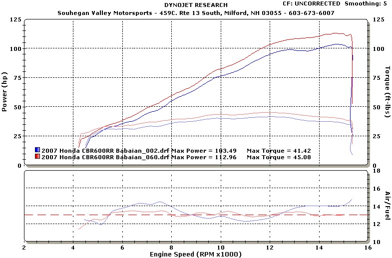

    I wasn't saying they suck, just their midrange sucks so they require more shifting. the R6 is actually my second choice right behind my CBR.
    new graph after a few more pulls. need .04 more noticed these numbers are uncorrected and the dyno sheet I have from the previous owner where it said 109hp was SAE corrected. not completely sure what that means.
    You can't compare dyno numbers from different times and different dynos. It's not that accurate. You can only compare before and after on the same dyno in the same day. If there is an improvement it's good. but the actual numbers are sorta meaningless..
    SAE corrected means they've factored in air temp and elevation as an attempt to kind of even out the ability to compare different dyno numbers to eachother.
    #331 CBR929RE's Avatar
    Bridgewater, MA
    5,623
    Quote Originally Posted by Tunertype View Post
    I know they're all different. final evaluation is the butt dyno. I'll be able to tell then how much better it is.
    that's what I thought the correction was. thanks. what I like is that the stacks don't seem to cause any dip in the low/mid range. and its nice and smooth all the way up.
