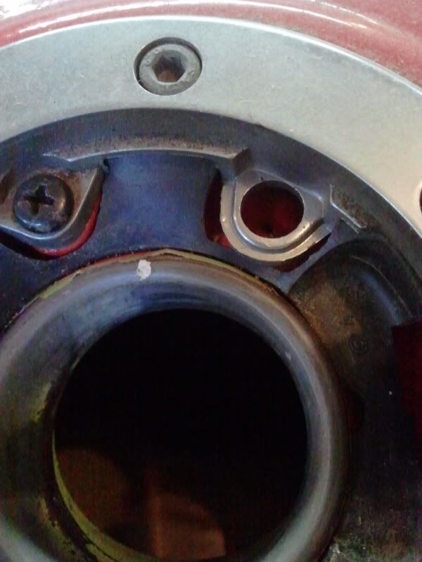

    This. I was getting the same symptoms on my 98 ex500. When opening your gas tank do you hear any air rushing out? I had to drill my tank to bypass the vent.

    Any other options to converting the petcock to manual? No part could be found on the link. Csmutty, where did you drill?
    Shitty pic, but you can barely see the pinhole I drilled. It's that dark spot inside that circle of metal.

    Re: 1994 EX500 Problems
    What's the clock position on the fill hole I should be looking at.
    1.
    In the blue circle. Drilled right through the metal of the tank so that it bypasses the gas cap breather.
    Oh, ok. I was looking on the outside of the fill neck. I may go for that too.
