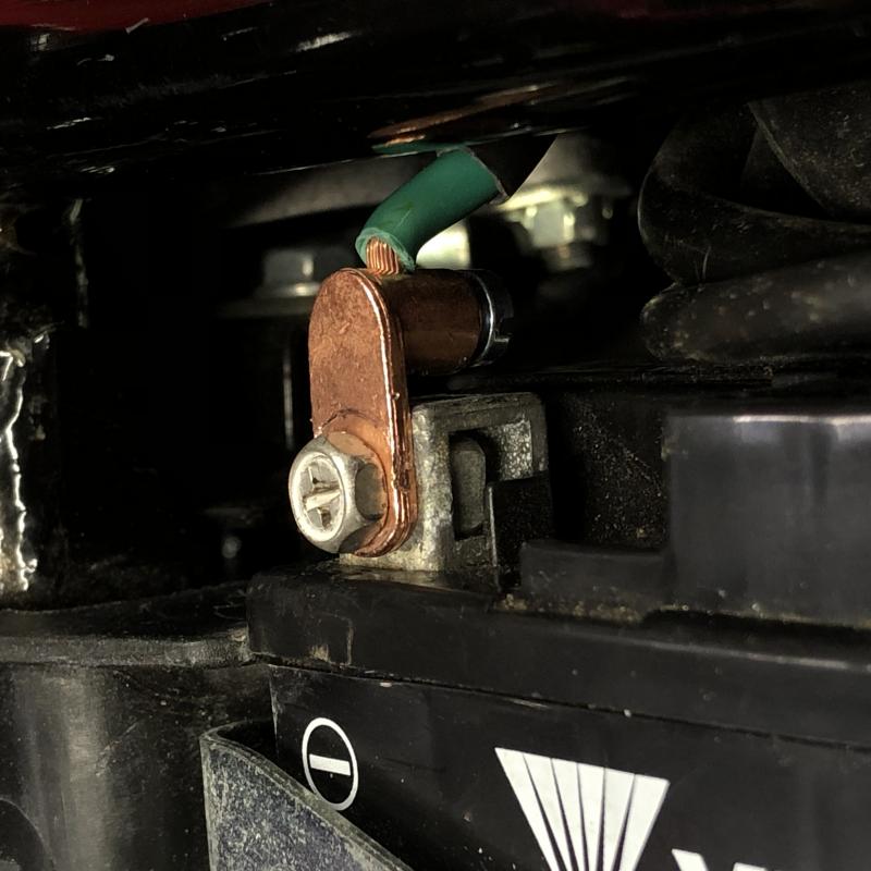

    Anyone know where I can get a replacement 90 degree battery connector like this?

    Looks like Amazon might have something.
    If all else fails you can probably repair that one with some soldering and a couple copper strips

    eazy fix. this was my HOT MOD on the Race HawkGT
    Home Depot should have something. its just a ground connector

    As they said ^^
    Last night I did a little searching for 90 degree battery terminals, most were for heavier cable, like 1 ga.
    If it wuz me, I'd try the repair route, and look at the other end, too, and inspect the whole length for kinks etc.
    In the past I've bought 4 ga. and 6 ga. battery cables from ... somewhere, used them to run an extra ground from the battery neg. to the starter housing. (Yeah, I'm repeating myself, but it's worth repeating.)
    OK, brain started working -- I buy electrical supplies from Del City -- take a look at their battery cable assemblies, eg,
    https://www.delcity.net/store/Tinned...818636.h_89497
    -- up to 49" in 4 ga.

    Poked around in Home Depot this evening. Found these https://www.homedepot.com/p/Southwi....0040/312648371
    Snipped off what was left of the old connector, stripped the wire back 1/4”, crimped this on, drop of blue loctite on the threads.
    Came in a 2-pack, so I’ll keep the other one around in case the same thing happens with the positive terminal.
