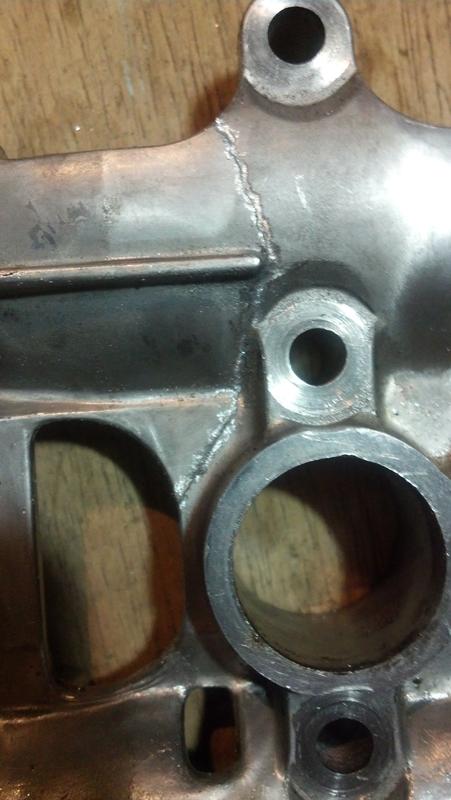

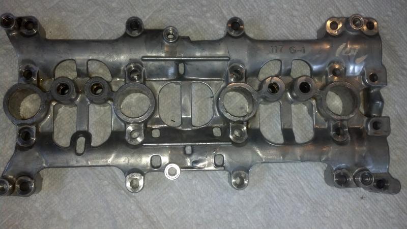

    This is the 3rd valve clearance inspection I've performed on my 99 ZX-6R, bike has just clicked 40K miles. Upon removal of the valve cover I take notice of a crack in the camshaft holder between cylinders 2 & 3. Looking at the parts diagram provided by Kawasaki made me suspicious that this part can not be purchased as a replacement. A quick call to Razee's confirmed my thoughts, the camshaft holder and cylinder head are essentially "married" in the factory and it is ill advised to swap these components.
    As usual I was given some great advise from the guys at Razee, I was told that these pieces have been welded for them before however the shop that has performed this work for them is no longer around. If I am unable to locate a highly skilled aluminum welder then I should start scouring the boneyards for a complete cylinder head.
    My first question to the NESR community, is there knowledge of an individual in New England that can perform this type of work?
    Second question, I guess I should start compiling a list of boneyards that might stock a complete cylinder head for my 99 ZX-6R? I know I can find a ton on Google but I'd like to know which ones are recommended.
    Pics attached for your viewing enjoyment.

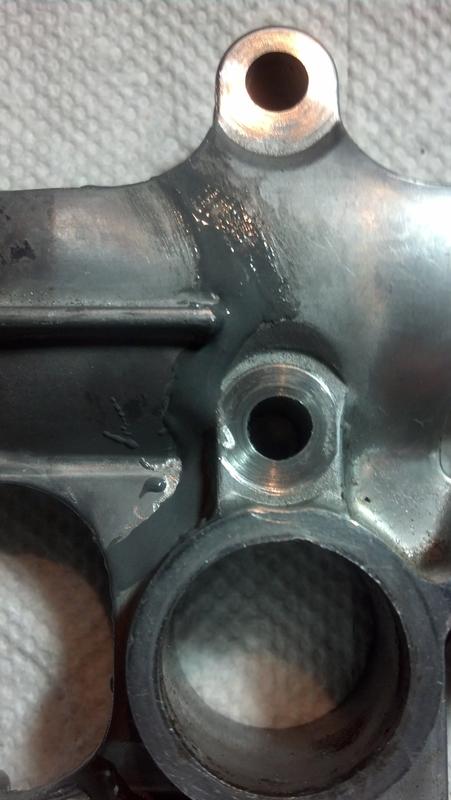

    Update: Used a dremel to make a slight channel in the piece along the fault line to give the JB Weld something to hold on to. Applied the JB Weld and it sat for several days before I could get to it. You can see the channel and the finished product. I took extra care of tightening the cam shaft holder back on to the cylinder head, the repair held under that strain of being compressed back on to the head.
    Thanks again for the pointers.
