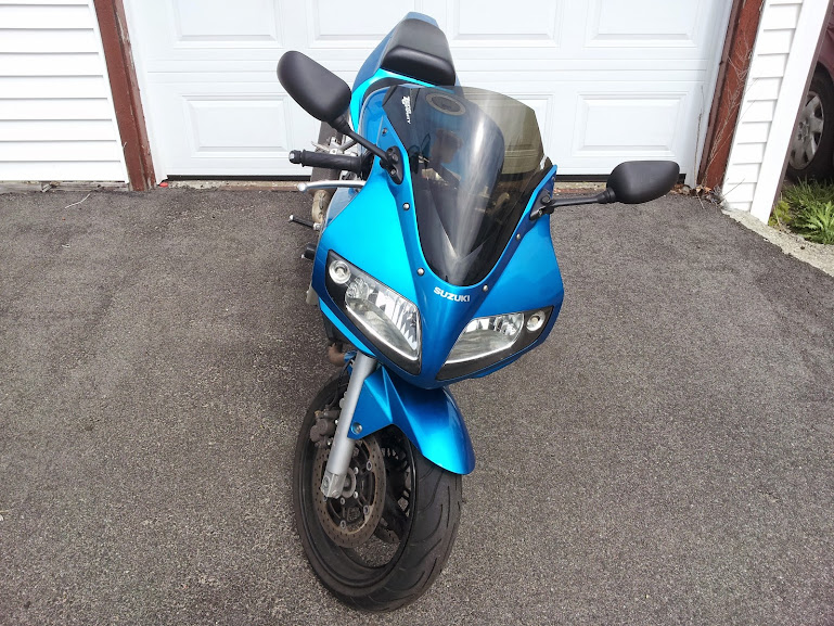

    Mine was in my parts bin with normal wear and tear, when my double-bubble cracked I hit the OEM on the backside with a can of gloss black and threw it back on the bike.
    Went from this:
    To this:
    If you prefer to keep it clear I would start with a headlight lens polish, a variety of which can generally be found at your local auto parts store.

    No, no... tape the front and paint the back. It won't start to chip off and stays shiny.
