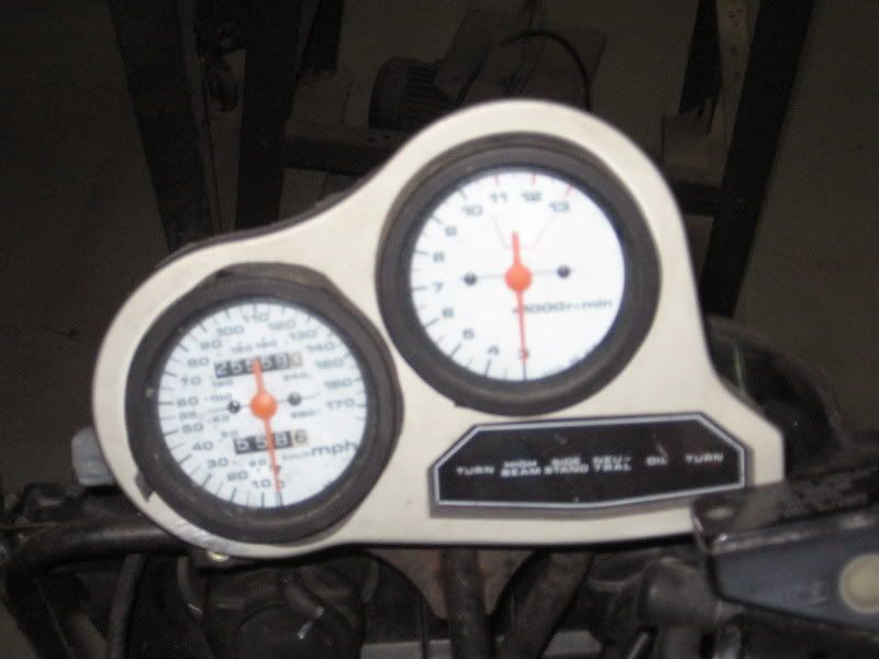

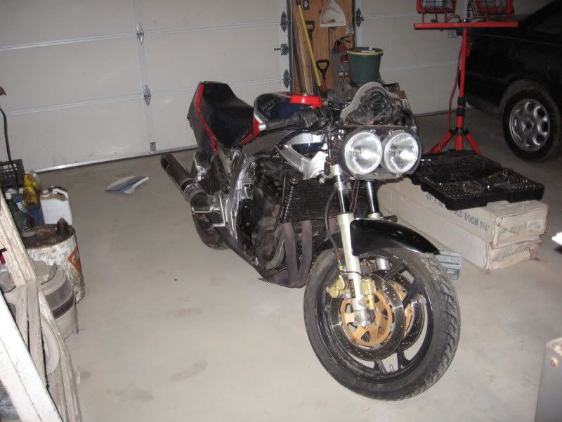

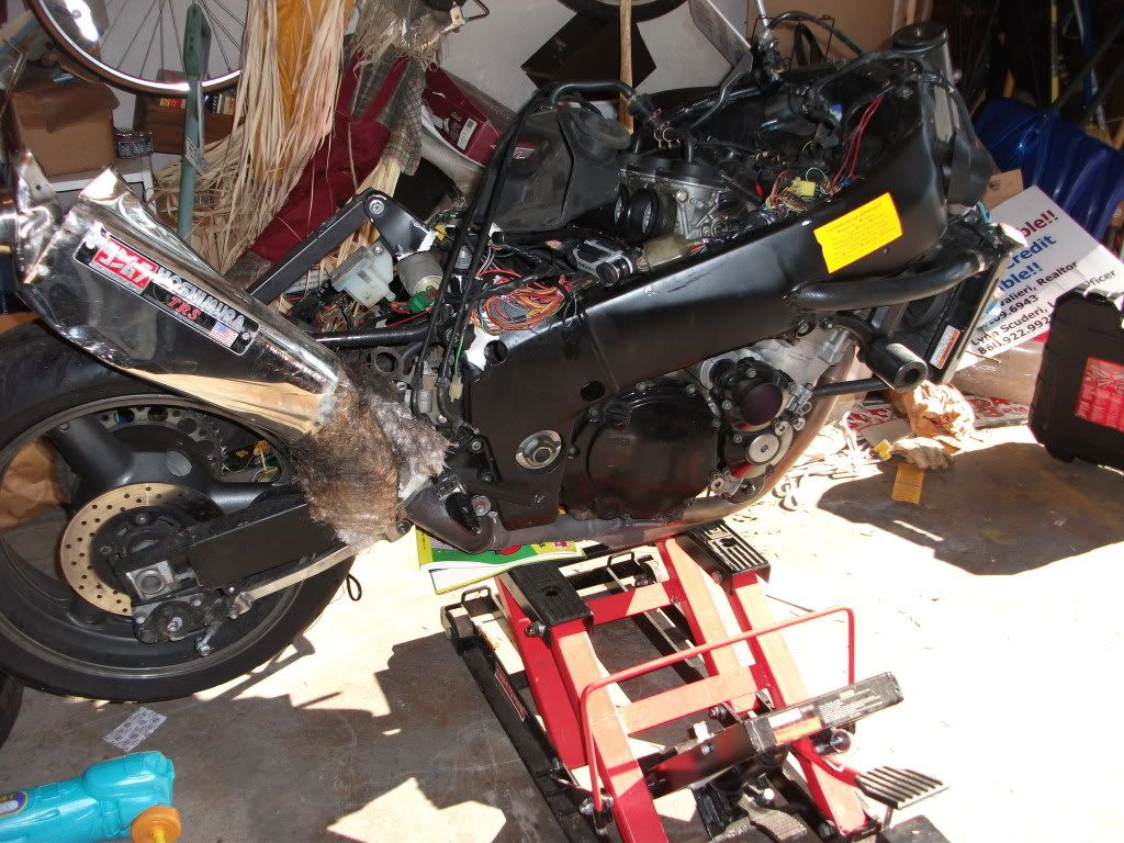

    Now that it is going to be getting slightly warmer I am going to be jamming on the 86 GSXR1100. Here is a list of what I have paid for and what I still have to find the funds for. The front end was off of Matt's (ilikenapalm) 99 GSXR600 and I got the bearing from Zoran to allow the triple from the 600 to fit int he 1100 frame. This front end has FZ1 calipers, master, and ss lines. The top triple already has the handlebar mounts on it, so that is all set for a pair of the fatbars to go on. The tail is going to be chopped but I am still trying to figure out what to do. My thought was to put a single seat on it and a very small tail behind that, like 2 or 3 inches, with a tail light and blinkers as well as the license plate under that. The valves are all done now and I also got a stage 3 jet kit off ebay for mad cheap. The rear tire on it right now is a 160, so I am planning on putting a 180 on the rear, or maybe even a 190, depending on what I have left over in the basement. I want the rims to match in color so I will be stripping them and having them powder coated. Haven't heard back from the place yet so that price is just an estimate. I will also have to strip the gas tank and paint that. As of yet I have not decided on a color yet. The headlight is black though. Also will clean the carbs when installing the new needles and jets. Trying to decide whether or not I want a front fender on it as of now too. Anyways here is the list of expenses

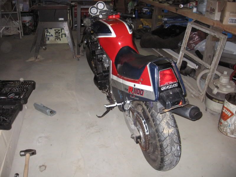

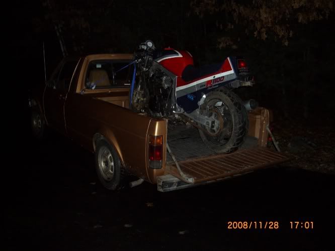

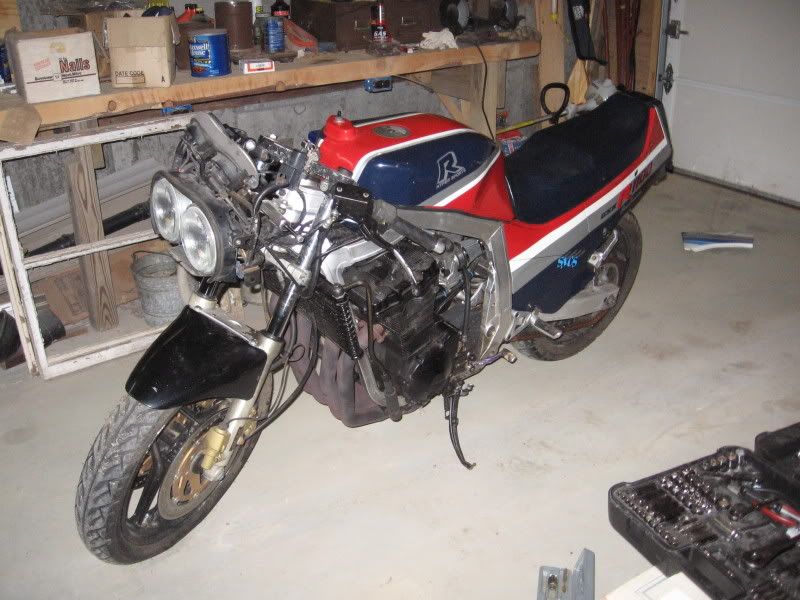

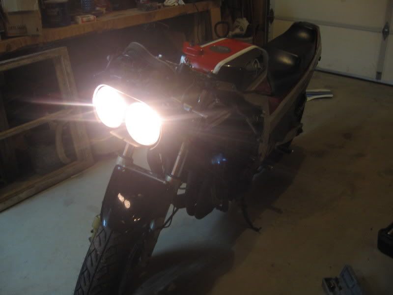

    And some pics of when I first got it:

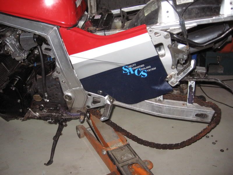

    and my favorite thing about the stock plastics...
    Those pics are from a while ago so I will get some updated ones once I put the oil cooler and front end back on.
