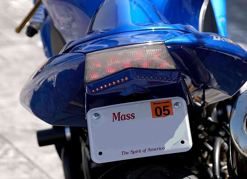

    The LED's in the undertail for Double"D"s ZX-10R are very hard to see during the day but are easily seen at night. Take a look at them in the dark and I bet you'll see a difference....

    yep my lights are just like that in the day time rice rocket....................just came in from checking them in the dark and they are pretty bright.Maybe i just thought they should be brighter than they were because i seen a friends on his gsxr and they were super bright even in the day time which is mostly when i ride because i have to look after the little one. honclfibr thanks for the run down on how the led functions ..
