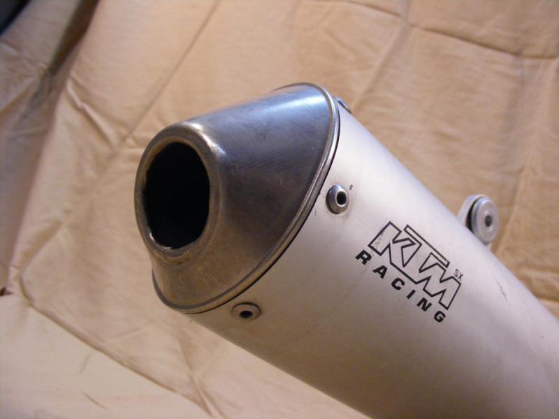

    On a related note, I mentioned possibly changing the muffler.
    I got my hands on a stock muffler for like $50, the guy said was off of an SMR (even though it says "SX" on it )
    I don't want to put something that's more restrictive than the aftermarket muffler that's on it now, but the exterior of the muffler that's on it has just given out.
    So the way I see it, my options are as follows:
    1. Install the new muffler as-is
    2. Take apart the new muffler, if the internals seem to be more restrictive, install the baffle from the old muffler inside the new can
    3. Go get a replacement aftermarket muffler (really not looking to lay out the cash right now).

    Re: Jetting a carb ('02 KTM 520SX)
    For what it's worth, the can that's on there now is the stock SX can with a different end cap so that I could run a spark arrestor in the woods.
    Ok, that's reassuring. Likely that I won't make it worse by installing the replacement I've got then. I wasn't looking forward to taking it apart b/c it's all rivets.
