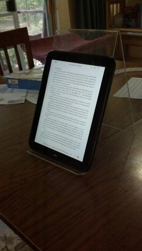

    I got Brenda one of the closeout HP Touchpads, and was really annoyed at having to hold it the entire time I used it. Here's what I did with a scrap piece of Lexan (3/32 thick). I just heated the areas I wanted to bend with a propane torch and then bent them over the edge of the workbench:
    Learning to Bend Lexan-bending-lexan-1-jpg

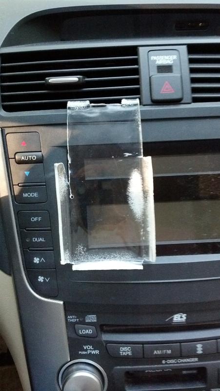

    Next, I fooled around with an idea for mounting the Droid Razr in the car. You can see where too much heat from the torch caused the moisture in the plastic to cause bubbling when it got too hot.
    Learning to Bend Lexan-bending-lexan-2-jpg
