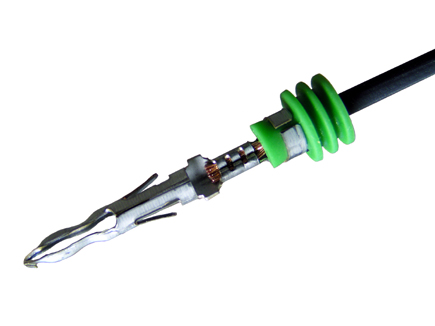

    I was just making damn sure that i was getting a good connection since I didn't have a proper crimping tool.
    After seeing that picture... I don't think mine looks quite as pretty any more

    That there looks like a terminal for a GM weatherpack connector? Totally worth the $20 investment for the proper crimping tool. I use those things all the time and there totally impractical to assemble without the crimp tool. With the tool they take 2 seconds to assemble and look like that picture every time.
    Tim
