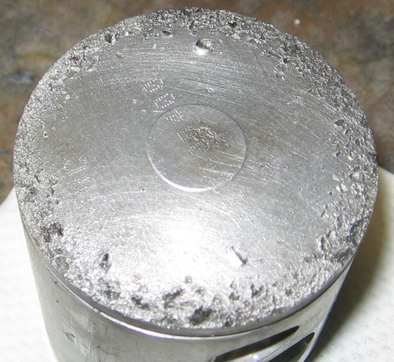

    Some of you may remember my thread about rebuilding my KX125, detonation had the head & piston looking like they'd been a backstop for a shooting range. I rebuilt the thing with wiseco stuff and it runs great, probably twice the power as before. Powerband lofts the front end in almost every gear now.
    The downside: Under load, 3rd gear and above, lower part of powerband it sounds like there's a lotto machine shuffling those stupid numbered ping pong balls in my engine. The bike will rev right past it, but i think it's safe to say the noise can be filed under the "bad things about to go catastrophically wrong" category.
    My first thought was detonation, but 6 fingered man rode it and said it doesn’t sound like detonation. He knows his shit and I don’t, so I’m inclined to believe him. I’m still going to pull the head and have a look, but I’m thinking maybe something in the bottom end isn’t liking all the power the new top end gave it? Any suggestions, anything to look for? I was hesitant even posting with such a crappy description, but I don’t know how else to describe the sound. Aside from that the thing runs tops. Gobs of power, first kick every time (unless it falls over in the trailer and sits that way for god knows how long, then it needs Daniel to push-start it the first time and it goes right back to first kick).

    edit: Old piston wasn't melted, it was scored with what I was told were detonation marks.
    So was the head

    If jetting were lean, it wouldn't have survived southwick. That's about as much load as you can put on a 125! I'd still pull the head to check it. I actually did that after two motos just to verify that I could lean it out a little.

    Those are not detonation marks those are marks of bit of metal wallowing around inside the cyclinder whilst it was running. Normally that hit the spark pleg electrode and the bike stops running.

    That is in fact detonation. A part rolling around in there would leave much more uniform and recognizable pattern. You could likley ID the part from its imprint.
    The dets could have been cause by an air leak, but you do need to verify jetting and compare it to stock or commonly known settings.

    The head will be pocked because it's the same one. Had a bunch of people and my local shop tell me run it, it won't matter save for a percent or two in power. They were also holding the parts, so I figured they were in a position to make the call, especially when the call was "you don't need to spend $ on this. We'll order you a new one if you want but if it were mind I'd just run this". I will be able to tell if the piston is pocked though, since that's brandy new.

    Check the piston for marks. Note the jetting settings, including needle and clip position, and get back to us.
