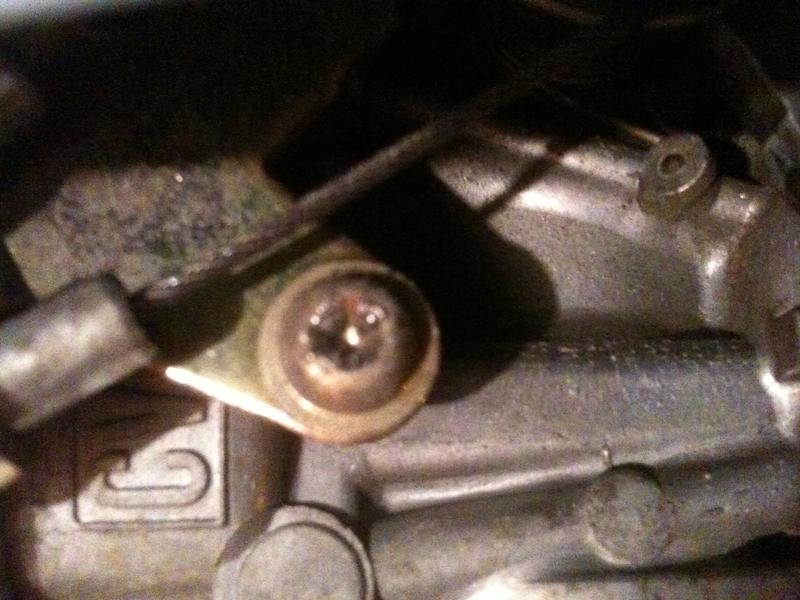

    That being said, since it was running poorly, I tried to start a carb cleaning tonight. I almost got the carbs completely off the bike, but then realized I needed to release the throttle cable to get them off. I took one look at the screw holding the throttle cable bracket to the carbs and realized the screw was 95% stripped by the previous owner. Here's a picture of the stripped screw:
    Small Problem, Major Stress - Please Help!!!-stripped-jpg
    So first I tried a large phillips head - and just stripped it slightly more. Then I tried a wrench - nothing (the screw has curved edges). Finally, I tried a GrabIt Pro drillbit (stipped screw tool). Big mistake. The bit sunk into the screw like butter and just spun - the screw is fucked.
    Anyways, I need help getting this fucking throttle body bracket off the carbs so i can get the cable off of the carbs and the carbs out of the bike to clean them. I honestly have no idea what to do with this stripped screw. Maybe grind the rounded edges off of the screw and try wrenching it off?

    Plenty of options, none really good:-)
    If you have a dremell or even a hacksaw you can try making the Phillips head screw into a flat head screw and try using a flat head screwdriver to remove it.
    From the pic you posted, you might also try a larger screw extractor. It's hard to tell, but from what I could see in the image screw extraction still has a chance.
    Failing those options grinding off edges of the head are an option,but I'd be more likely to try either channel locks or vice grips rather than a wrench.
    If all of those fail, last option would be to simply grind or drill the entire head off. This would allow you to get the damn thing out. Problem with this is now you have the entire thread stuck in with no simple way to get it out, and you can damage the threads in getting it out. Depending on whether or not the thing is "torked" on or there is an issue with the threads being stuck might lead to different approaches.
    If it's something in the threads, use some spray penetrant. Wait for a bit. Use some more. Hell, use some as step 1 regardless.

    Soft screw + aluminum carb body = corroded threads. Try penetrant spray.

    If it's buttery soft, vice grip the shit out of it. First impressions count, so make sure you clamp it wiccchhhhhid tight. Filing some flat spots on each side might not hurt.
    Don't forget to use PBBlaster on it first, and if its in a safe area without much rubber or fuel near by, heat it with a torch a little. Torching helps break stuff free. I'd be really surprised if it needed torching, but it doesn't really hurt either as long as you're aware of your surroundings.

    Next time, use a JIS screwdriver ... If it looks like a Phillips screw BUT has a dot stamped on the side, it's a JIS screw. Problem is not the metal, it's the wrong tool being used.
    Google JIS ... every "Phillips" screw on the bike is JIS.

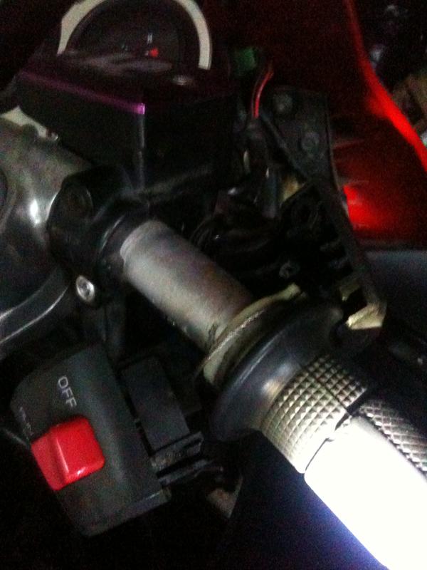

    Small Problem, Major Stress - Please Help!!!-throttle-assembly-1-jpg
    Small Problem, Major Stress - Please Help!!!-throttle-assembly-2-jpg
    It took all of maybe 5 minutes. I guess taking off the throttle assembly (instead of unscrewing the throttle cable bracket) every time I want to clean my carbs isn't the worst thing in the world - like I said, it took maybe 5 minutes, and that is because I had no idea what I was doing.
