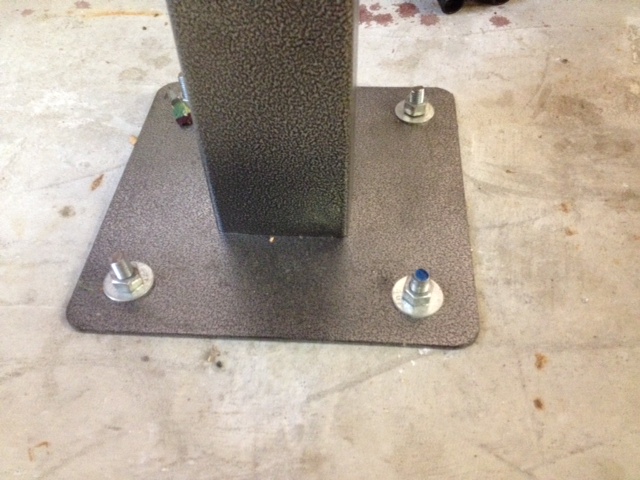

    Re: No-Mar JR pro tire mount floor base.
    Here's a quick photo.
    Quote Originally Posted by imstuner View Post
    Thelglu: Was the pallet stable enough?
    Yes. As long as you stand on it when using it, it sure is. Only time I ever needed someone else to stand on it for stability was when I was mounting my truck tires.
    When I first bought mine, I tried to anchor it to a piece of plywood but I found it didn't work that well. If you have some stubborn tires when mounting and removing using the bar, I found the wood wouldn't handle the torque.
    Less then 5 minutes with a Hilti hammer drill, proper bit, and some concrete bolts and I was cooking with gas.
    If you're looking for a temp mount, I think they still make one that goes in a 2" receiver on a trailer hitch.
