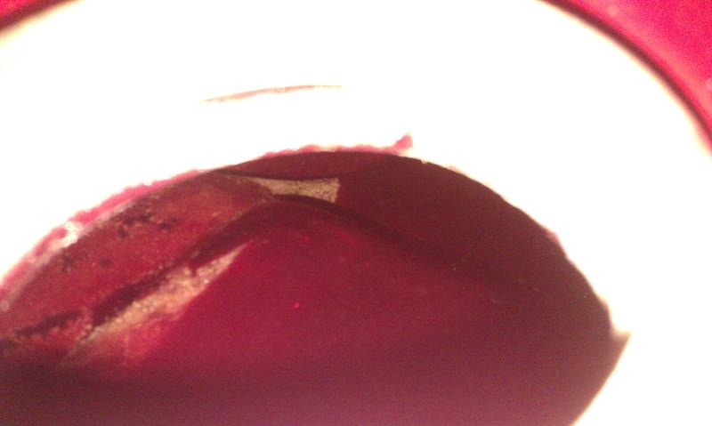

    So I went to ABC in Framingham. I am not happy with the results. They used Red-Kote (what Rogers uses) which from what I've read online is a pretty good product and better than kreem. I am regretting not using Rogers now and actually called them and they said it doesn't sound like it was done right. I am considering shipping it to them to get re-stripped and coated.
    So the question being would you guys find this job acceptable? And furthermore it looks like hell, but do you think it will hold up? It was $150, which is an on-par price for the service (but in my mind not this kind of quality).
    There are gobs in it, strings hanging from top to bottom, and some spots don't really seem covered. I went back there today to which i was told its 'normal' with this product, and they would re-do it but it would come out the same, or they could do another coat which seems stupid since these globs/pools would still be in it. I also asked what if pieces come off to which the reply was, put a fuel filter on.

    does not seem like they got it all.
    agreed.
    does anyone think its a bad idea to run it as-is?

    I ended up emailing Damon Industries (company that makes Red-Kote) and the CEO got back to me and informed me that this is not how red-kote is to be applied. I am going to leverage that and talk to the shop for my money back and try to mail it to rogers since Damon Industries said running a tank like that will cause issues. Will keep everyone informed. I will be happy to copy the email once I get her (CEO's) 'ok'.

    That is NOT applied correctly. That's a crappy job they did there. Rogers radiator does the job for local bike shops (I know Bettencourts uses them).

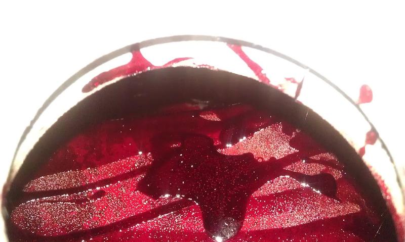

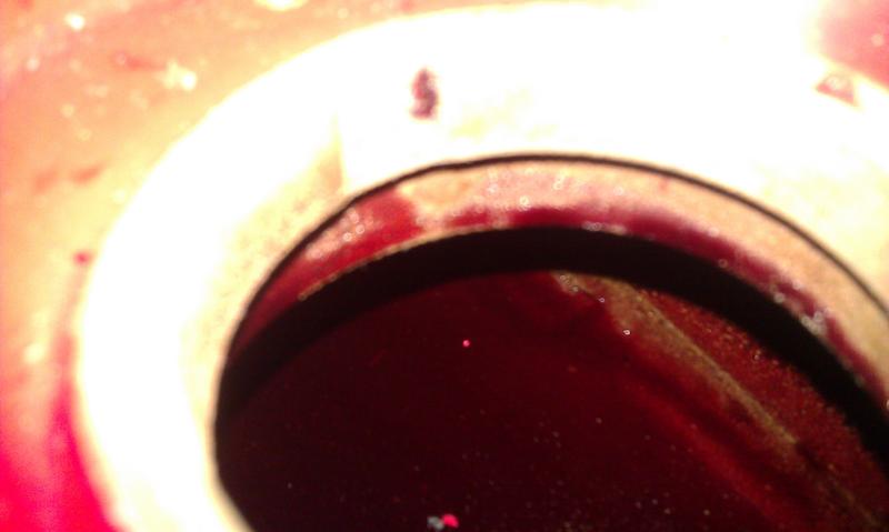

    So i ended up shipping this to rogers and just got it back today. box looked pretty banged up (different than the one I sent it in) and that should have been a sign. Unfortunately I'm not really happy with this job either. Here are some pics, am I being too picky? They didn't even clean out the petcock hole. the one picture that looks like a 'cross' in it is where i lightly pressed a 90° pic. this had been shipped last friday, it should be dry by now i'd hope or they had too much goop in it like the last shop.
    this job was $75 more than usual to clean out the other shops work. I don't feel like its worth $225. thoughts? I'm really looking for honest opinions before i reach out to rogers to ask them their thoughts.
    On top of it all the two most down points got bent. not a big deal i guess if everything else was ok, and could be USPS's fault but aside from cellophane there was NO padding on the bottom except for the box.

    The application looks better, but still looks like not much care was given. And the piss poor shipping shows it. That DIY that you sent me looks 10x better than this job.

    so i called rogers and spoke with the owner. he said the pliability is "normal" of this product where i can easily make indents. Keeena actually saw the tank and left a fingerprint on the coating just by touching it. doesn't seem right to me. they also told me to 'drill' out the coating where it had been solid in the petcock hole. I emailed damon industries again to see if this is correct. I also put up an ad for a tank. ugh.
