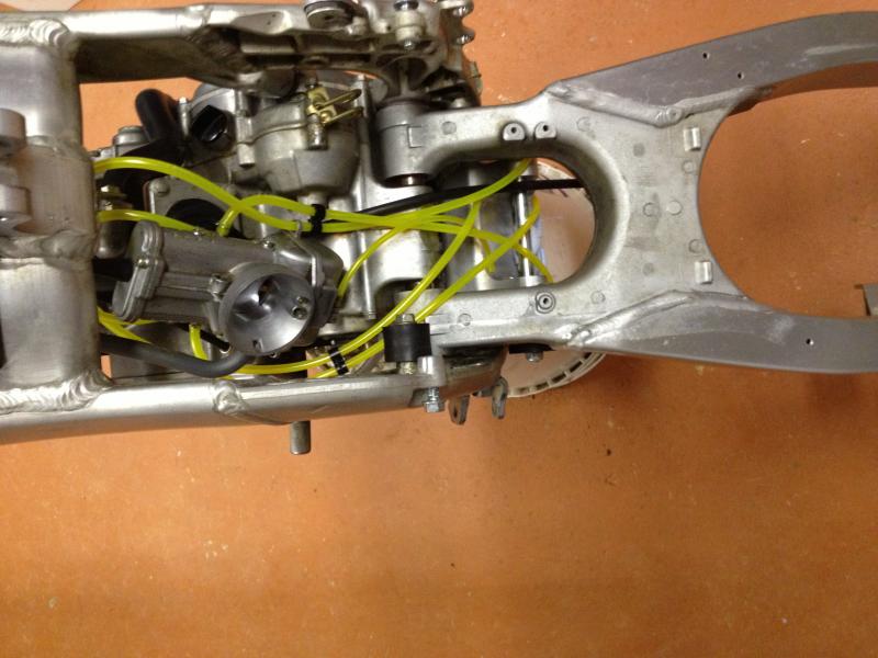

    I've used a length of steel rod through the swing arm pivot bolt and jack stands under it. 2 person job though, 1 to lift and 1 to place stands. The 5 gallon pail works on the light machines!
    Attached Thumbnails Attached Thumbnails shock remove/install-image-jpg
