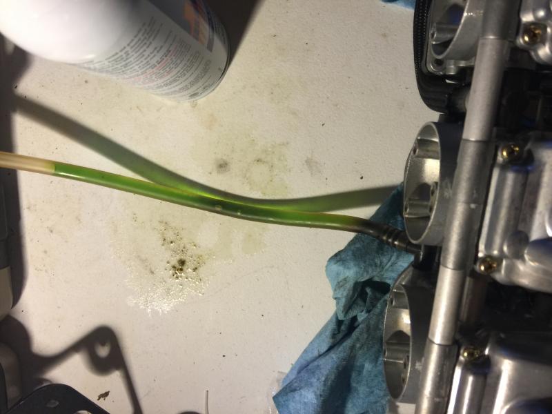

    Re: Suzuki Bandit won't start
    Turned the carb over and this started coming out
    Suzuki Bandit won't start-image-jpg

    13,272
    That's likely the copper components reacting to the moisture content.
    Be prepared because those things are probably going to be a mess.
  25. #50
    Dublin, NH
    5,784
    That's what came out of the carb of a Chinese scooter I had. It's been sitting way too long to work properly, you'll most likely need to tear it apart and clean it out or even possibly rebuild it completely. You should also probably flush all the gas lines.
