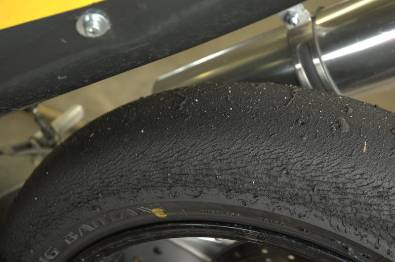

    So I've got some carb work to do still, but other than that, the FZR and I are starting to work well together. I shredded the left side of my rear tire, guess I'm going fast enough now that I really need to pay attention to wear, heat cycles, pressures, etc.

    Guess I've got to really pay attention to my pressures now. Anyone wanna read this tire?

    Re: AM #771 - Round 5
    I hear reading tires is kind of a black art but I've seen some look like that and playing with rebound fixed it...
