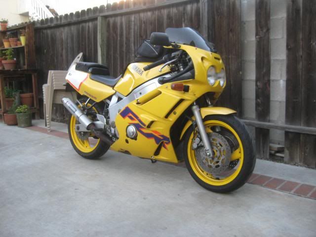

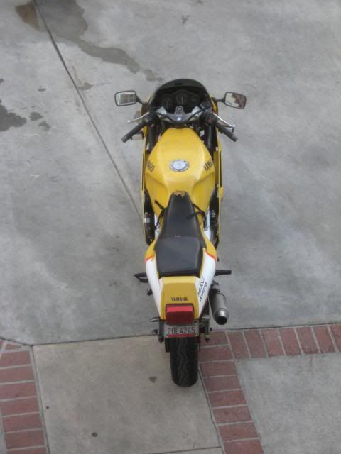

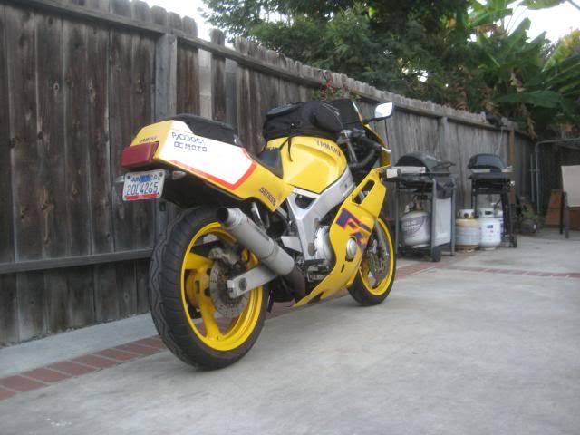

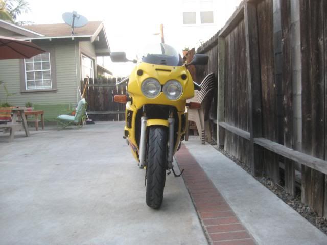

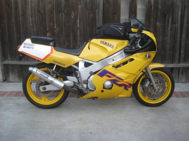

    mine still seems to be running...she spits black smoke during warm up (placing a white piece of paper shows a collection of black soot)...
    but I put the lower fairings back on and cleaned her up...pics before the birds poop on it!
    she's so puurrrrty...I wish she would just live forever!
