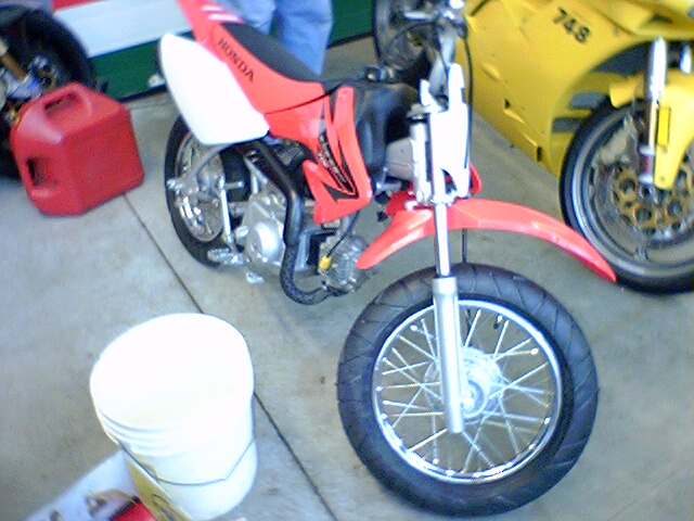

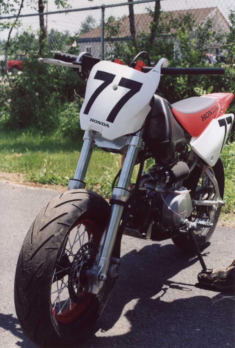

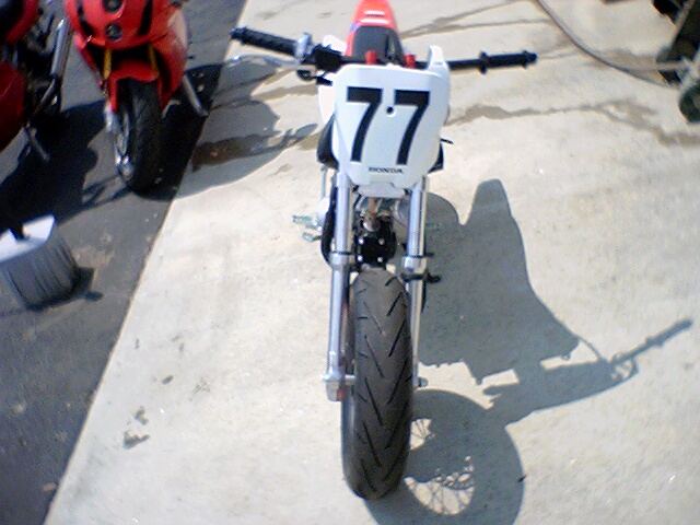

    The Diablo should work decently. Primary problem with 14" wheels is finding tires that aren't ridiculously huge, the 90/90 will still have a reasonable profile on a skinny rim. In back, same idea, you don't NEED a 120 for tooling around. IF you do go the 120 route, get a 120/80 instead of a 120/70 or 120/60, you need that sidewall height to have a fighting chance of having a usable profile.
    As examples:
    - A bad 14" tire choice: http://www.x386.net/TTR/media/CRF70F-Motard1.jpg
    - Not enough sidewall height on a 12" rim: http://www.x386.net/TTR/media/CRF70F-Tire1.jpg
    - A pair of Dunlop 120/80-12 on skinny 12" rims: http://www.x386.net/TTR/media/PR/front-in-progress.jpg
    - Same 120/80-12, front view: http://www.x386.net/TTR/media/unsorted/DSC00134.JPG
    - Dunlop 100/90-12 on skinny 12" rim in front: http://www.x386.net/TTR/media/unsorted/HPIM0358.JPG
