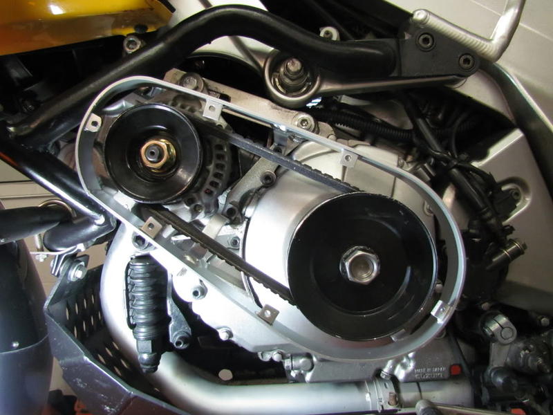

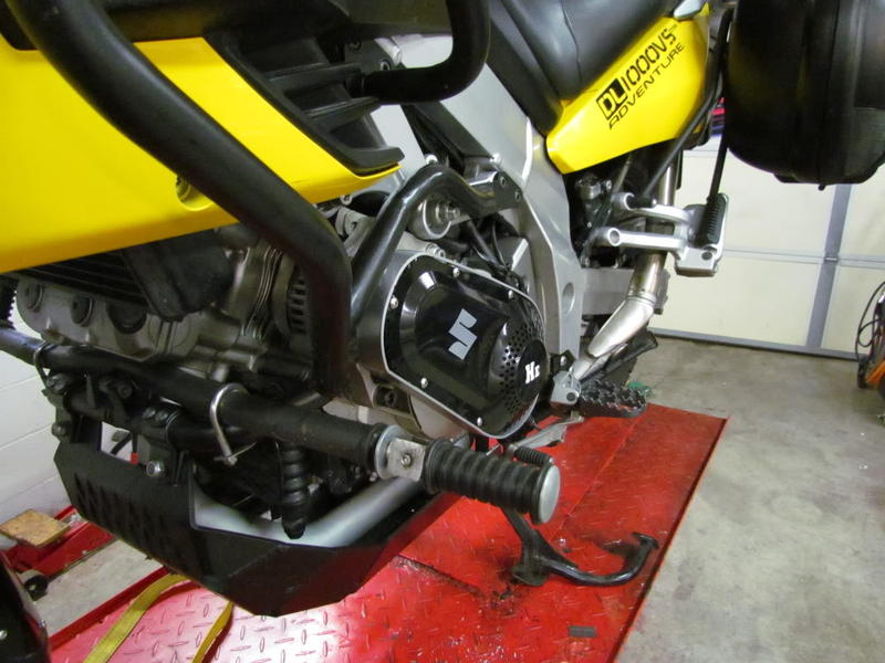

    I have acquired a debugged & operational prototype external alternator system. 60amp 1 wire alternator. I will run it completely independent (except a relay that will tell the auxiliary system when the bike is running) for my accessories. I will also use the auxiliary battery as an emergency jump start battery for cold weather (I know from experience, bike batteries don't have the cranking amps to start a bike much below -10°F) so I plan the biggest automotive battery I can find space for. I make room for a battery, I have decided to convert the dual exhaust to single exhaust and hang the auxiliary battery where the exhaust was
    Charging systemRandyO's V-strom 1000 built project-img_0457-jpgRandyO's V-strom 1000 built project-img_0463-jpg
