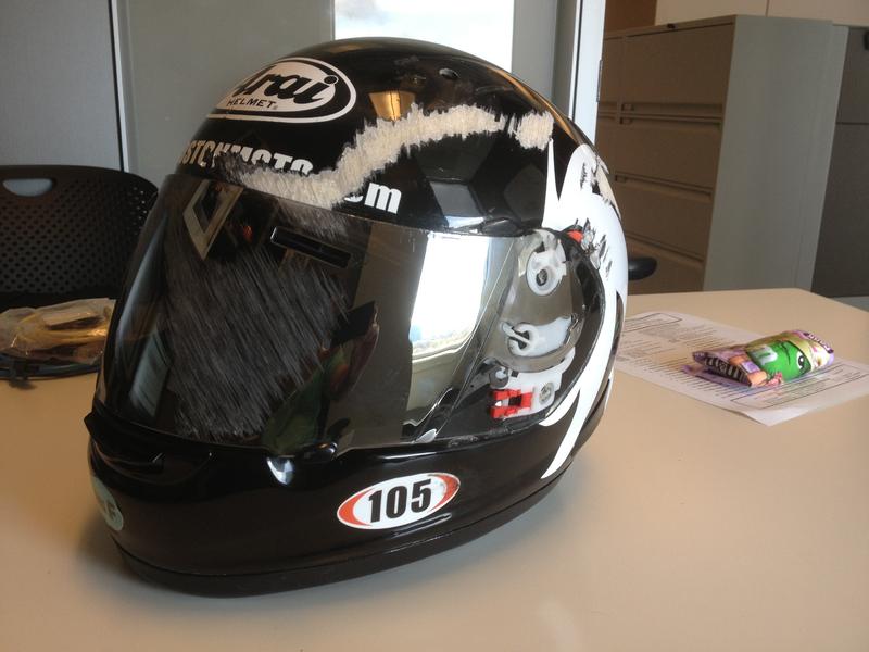

    For those who were at the races this weekend, I got hit by a rider in T11a and knocked off my bike.
    Fortunately, my face broke my fall.
    So I just got my helmet X-Rayed at work and it looks clear.
    I'm getting the images burned on a CD now and i'll post them soon.
    What I want to know is how can you tell if the foam has been activated?
    Tech took a quick look at it on Sunday and said it's not reusable, but there's no indication that the foam has been pushed out.
    I'm hoping Graham or someone smart has will chime in here.
    FYI - I already did buy a new helmet for this weekend's CCS round at NJMP, but was considering fixing up this helmet and keeping it as a spare.

    Tech has to go by visible damage. If its structurally on and you have it repaired/painted I'm sure it will pass.

    Pull the liner. You would see any crushed foam. Some companies paint it black so you can easily see white where the foam has cracked.

    That helmet is fine.

    Eh, I dunno man. I'd be interested to see what a known, definitely damaged helmet x-ray looks like for comparison. How subtle does the damage appear? You're not really looking for a big crack, right? Just a small compression of the polystyrene is enough to scrap the helmet?
    Here's a question, though... could the polystyrene have compressed (maybe just a little) on the shell side and show no visible damage on the head side?

    We use ultrasound to inspect for damage in composites. I don't know too much about x-ray, but IIRC it looks for density variations and wouldn't be an appropriate tool for inspecting for cracking and delaminations.
    Re: the foam - this would worry me less; any force to the outside of the foam would have an equal/opposite (and less evenly distributed) force on the inside that would be visible.

    If it were me and I even had the thought of wearing it again I'd send it in to Arai to get checked. the helmet I crashed in last year only slide lightly on the pavement and I didn't use it again. could just bought a new side cover and top wing and been good to go but I never even looked at the foam inside. the channels in a Suomy make it easy to see compressions. you face planted and were even worried you had a concussion so I'd toss it on a shelf

    If you even have to ask this question, I would retire the helmet. You will only have this little voice in the back of your head asking the same question over & over if you put it back on.

    You're questioning it, replace it.
