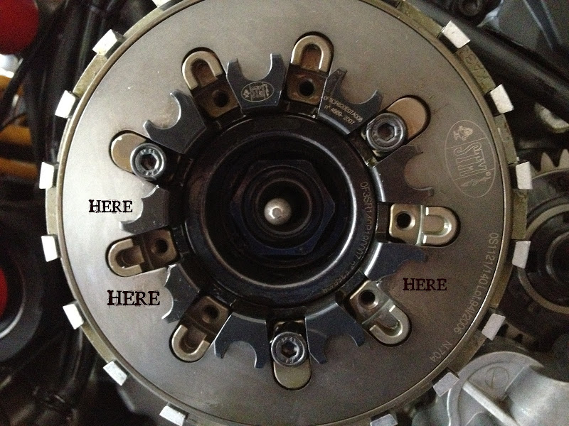

    Yes, I am a believer in the STM slipper also. Different models for different bikes of course, but I run one in my 848 with the stock plates and it is great. Install was a bit of a pain, the outer spider clip broke off in two places during install, but it's held up over many thousand miles of hard use. I bang out downshifts way early and bike is unfluttered. My new bike has a factory slipper and is noticeably not as good as the STM slipper.

    That's funny, whoever owned mine before did the same thing breaking those little tines. Was it just not lined up? I don't even see how it happens.

    It's more to do with the clutch holder tool holding the hub down while you tighten. I have the motion pro tool that's made for dry clutches. You can use it on the 848, but you have to use it backwards (hard to explain - see photo) on a wet clutch. If the hub slips as you tighten, the spider clip is likely to pop. I am not looking forward to the day when I have to put new clutch plates in. I miss the dry clutch.

    OK, I see. I used the holder tool on the outer part of the basket to torque the nut. There were a few spots where I could get it to bite enough.
