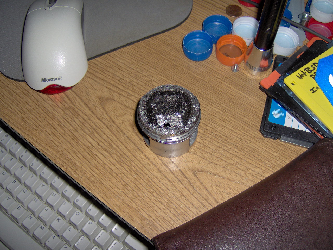

    I was loaned a head to test from a friend after he put some serious time into reworking it, heavily reshaped ports and combustion chamber, 5 angle valve job, etc. He suggested I go up on my main a couple sizes before running it on the dyno. I was thinking a good baseline comparison with the same jetting would be a good idea, not realizing just how radical the changes were between this head and the one I had been running were. Both were ported, both 'looked' similar to my untrained eye...
    The holed piston on the first warm up pull suggested otherwise.
    It did that before I could shut the bike down. Pulling good, no signs of trouble, then it just lost power. By the time I realized something was wrong it was already toast. Head was just as lunched as that piston.
    I still get ribbed about that every time I step near the dyno.
